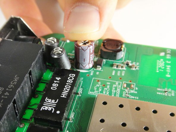

This guide will take you through the process involved with removing a capacitor. De-soldering and soldering will be required.

    1. Netgear WGR614v9 Capacitor Replacement, Capacitor: crwdns2935265:07crwdnd2935265:01crwdnd2935265:02crwdne2935265:0 Netgear WGR614v9 Capacitor Replacement, Capacitor: crwdns2935265:07crwdnd2935265:02crwdnd2935265:02crwdne2935265:0
      • Rotate the motherboard so that the top is facing up.
      • Set the motherboard on a flat clean surface.
    2. Netgear WGR614v9 Capacitor Replacement: crwdns2935265:08crwdnd2935265:01crwdnd2935265:02crwdne2935265:0 Netgear WGR614v9 Capacitor Replacement: crwdns2935265:08crwdnd2935265:02crwdnd2935265:02crwdne2935265:0
      • The capacitor can be found at the location shown.
    3. Netgear WGR614v9 Capacitor Replacement: crwdns2935265:09crwdnd2935265:01crwdnd2935265:02crwdne2935265:0 Netgear WGR614v9 Capacitor Replacement: crwdns2935265:09crwdnd2935265:02crwdnd2935265:02crwdne2935265:0
      • Rotate the motherboard so that the bottom is facing up.
      • Locate the two soldered contacts of the capacitor.
    4. Netgear WGR614v9 Capacitor Replacement: crwdns2935265:010crwdnd2935265:01crwdnd2935265:03crwdne2935265:0 Netgear WGR614v9 Capacitor Replacement: crwdns2935265:010crwdnd2935265:02crwdnd2935265:03crwdne2935265:0 Netgear WGR614v9 Capacitor Replacement: crwdns2935265:010crwdnd2935265:03crwdnd2935265:03crwdne2935265:0
      • Rotate the motherboard 180 degrees.
      • Do not refer to the pictures in this step for proper de-soldering and soldering techniques. They are for illustration purposes only.
      • Refer to this link for proper de-soldering and soldering techniques.
      • Pull the capacitor from the other side of the circuit board once the solder is liquified.
      • To replace the capacitor, orient the negative side of the capacitor (indicated by a white stripe and a negative sign) so that it aligns with the shaded white region of the circle indicating the capacitor's position on the motherboard.

looks like that's a 220microF at 25V right ?
probably better to replace it with a similar 220microF, but with higher voltage rating.
