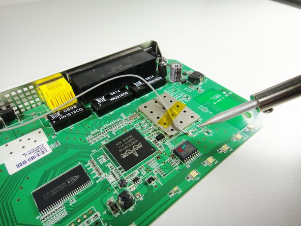

  7. Netgear WGR614v9 Antenna Replacement, Antenna: crwdns2935265:07crwdnd2935265:01crwdnd2935265:02crwdne2935265:0 Netgear WGR614v9 Antenna Replacement, Antenna: crwdns2935265:07crwdnd2935265:02crwdnd2935265:02crwdne2935265:0
    • Rotate the motherboard so that the top is facing up.
    • Set the motherboard on a flat clean surface.
  8. Netgear WGR614v9 Antenna Replacement: crwdns2935265:08crwdnd2935265:01crwdnd2935265:02crwdne2935265:0 Netgear WGR614v9 Antenna Replacement: crwdns2935265:08crwdnd2935265:02crwdnd2935265:02crwdne2935265:0
    • Do not refer to the pictures in this step for proper de-soldering and soldering techniques. They are for illustration purposes only.
    • Refer to this link for proper de-soldering and soldering techniques.
    • Be patient. This may take some time depending on the quality of your soldering iron.
  9. Netgear WGR614v9 Antenna Replacement: crwdns2935265:09crwdnd2935265:01crwdnd2935265:01crwdne2935265:0
    • Peel off the yellow tape holding the wires.
    • Set the tape aside on a clean surface so that it can be reused.

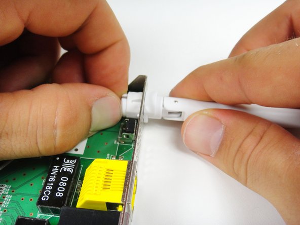

    • Extend the antenna outwards from the device so that it is straight.
    • Locate the clips that hold the antenna onto the router.
    • Push the clips in with one hand and pull the antenna out with your other hand. Slightly twist the antenna until it becomes free from the hole.
  11. Netgear WGR614v9 Antenna Replacement: crwdns2935265:011crwdnd2935265:01crwdnd2935265:01crwdne2935265:0
    • Pull out the antenna as well as the connected wire.
