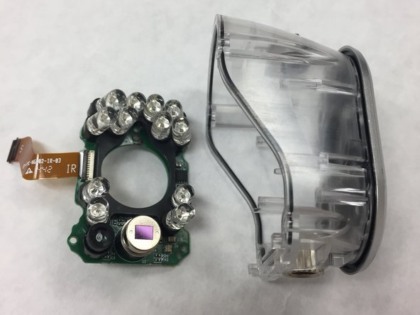

  10. Netgear Arlo Infrared LED Board Replacement, Infrared LED Board: crwdns2935265:010crwdnd2935265:01crwdnd2935265:01crwdne2935265:0
    • Remove 3 (.150") screws from the sync board using the JIS00 screwdriver.
  11. Netgear Arlo Infrared LED Board Replacement: crwdns2935265:011crwdnd2935265:01crwdnd2935265:02crwdne2935265:0 Netgear Arlo Infrared LED Board Replacement: crwdns2935265:011crwdnd2935265:02crwdnd2935265:02crwdne2935265:0
    • Use the plastic opening tool to slowly pry the board away from the front housing.
