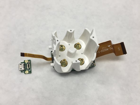

  10. Netgear Arlo Charging Port Replacement, Charging Port: crwdns2935265:010crwdnd2935265:01crwdnd2935265:01crwdne2935265:0
    • Remove the 2 (.135") housing screws with a JIS00 screwdriver
  11. Netgear Arlo Charging Port Replacement: crwdns2935265:011crwdnd2935265:01crwdnd2935265:01crwdne2935265:0
    • Remove 4 (.135") screws on the inside of the battery compartment using the JIS 00 screwdriver.
  12. Netgear Arlo Charging Port Replacement: crwdns2935265:012crwdnd2935265:01crwdnd2935265:01crwdne2935265:0
    • Slide the two halves apart
  13. Netgear Arlo Charging Port Replacement: crwdns2935265:013crwdnd2935265:01crwdnd2935265:01crwdne2935265:0
    • Remove the 2 (.135") screws holding the charging port on using the JIS 00 screwdriver.
  14. Netgear Arlo Charging Port Replacement: crwdns2935265:014crwdnd2935265:01crwdnd2935265:02crwdne2935265:0 Netgear Arlo Charging Port Replacement: crwdns2935265:014crwdnd2935265:02crwdnd2935265:02crwdne2935265:0
    • Remove the ribbon by prying the black ribbon holder up using the opening tool.
    • Pull the ribbon away from the charging port.
