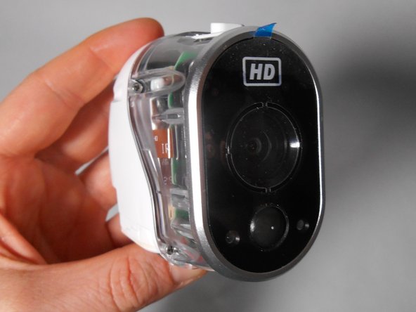

  5. Netgear Arlo 2 Camera HD Security System Front Transparent Case Replacement: crwdns2935265:05crwdnd2935265:01crwdnd2935265:02crwdne2935265:0 Netgear Arlo 2 Camera HD Security System Front Transparent Case Replacement: crwdns2935265:05crwdnd2935265:02crwdnd2935265:02crwdne2935265:0
    • Using the plastic opening tool, gently pry the right panel from the device.
    • Replace either side of the plastic case as needed.

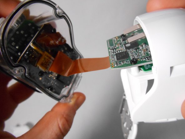

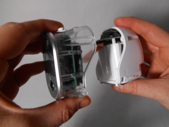

  6. Netgear Arlo 2 Camera HD Security System Front Transparent Case Replacement, Camera/Lens: crwdns2935265:06crwdnd2935265:01crwdnd2935265:03crwdne2935265:0 Netgear Arlo 2 Camera HD Security System Front Transparent Case Replacement, Camera/Lens: crwdns2935265:06crwdnd2935265:02crwdnd2935265:03crwdne2935265:0 Netgear Arlo 2 Camera HD Security System Front Transparent Case Replacement, Camera/Lens: crwdns2935265:06crwdnd2935265:03crwdnd2935265:03crwdne2935265:0
    • Unscrew the four 4.0 mm Phillips #00 screws on either side of the transparent case.
    • Separate the transparent half of the case from the white half.
    • Only separate the two halves enough for them to be apart. The flat ribbon cable is short and its connection is delicate.
  7. Netgear Arlo 2 Camera HD Security System Front Transparent Case Replacement: crwdns2935265:07crwdnd2935265:01crwdnd2935265:02crwdne2935265:0 Netgear Arlo 2 Camera HD Security System Front Transparent Case Replacement: crwdns2935265:07crwdnd2935265:02crwdnd2935265:02crwdne2935265:0
    • Lift the small thin black rectangular latch that covers the connectors of the flat ribbon cable.
    • The latch is very flat, so use a finger nail or a spudger to lift it. Do not use any sharp edge like a knife as it will likely damage the device!
    • With the latch lifted, the cable will pull away freely as you separate the white half from the transparent half.

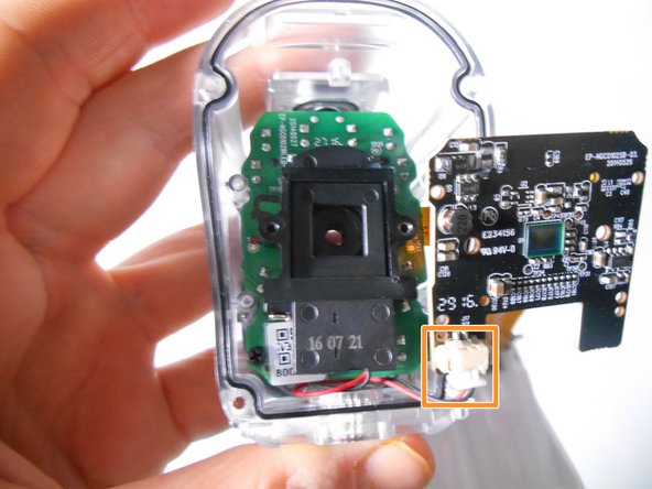

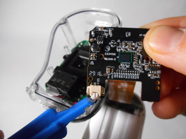

  8. Netgear Arlo 2 Camera HD Security System Front Transparent Case Replacement: crwdns2935265:08crwdnd2935265:01crwdnd2935265:03crwdne2935265:0 Netgear Arlo 2 Camera HD Security System Front Transparent Case Replacement: crwdns2935265:08crwdnd2935265:02crwdnd2935265:03crwdne2935265:0 Netgear Arlo 2 Camera HD Security System Front Transparent Case Replacement: crwdns2935265:08crwdnd2935265:03crwdnd2935265:03crwdne2935265:0
    • Repeat the same process as in Step 6 to release the flat ribbon cable from the black rectangular latch
    • Unscrew the six black 3.0 mm Phillips #00 screws that hold the black motherboard on.
    • Release the clip at the bottom left corner of the black motherboard by pinching the wings at either side of the clip.
    • Be sure that the transparent case or the black motherboard are being held or resting on a surface so that neither falls when the clip is released.

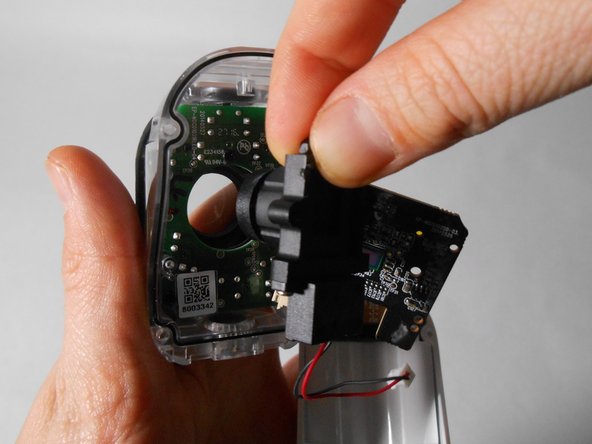

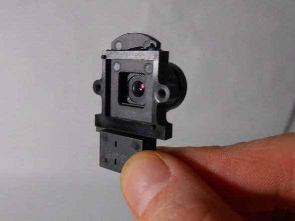

  9. Netgear Arlo 2 Camera HD Security System Front Transparent Case Replacement: crwdns2935265:09crwdnd2935265:01crwdnd2935265:03crwdne2935265:0 Netgear Arlo 2 Camera HD Security System Front Transparent Case Replacement: crwdns2935265:09crwdnd2935265:02crwdnd2935265:03crwdne2935265:0 Netgear Arlo 2 Camera HD Security System Front Transparent Case Replacement: crwdns2935265:09crwdnd2935265:03crwdnd2935265:03crwdne2935265:0
    • Remove the black plastic that contains the camera from its place.
    • Discard and replace this part as needed.
