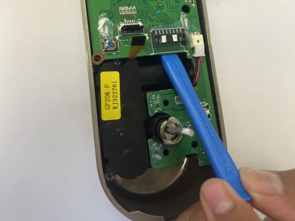

    • Get the lock device and turn it around.
    • Take out the black cover by removing the screws as shown in picture #1 and pull it out gently just so.
    • All 3 screws are 0.25 inches high and are phillip screws.
    • Doing so gains access to the motherboard as shown in picture #3.
  2. Nest x Yale Lock Speaker Replacement: crwdns2935265:02crwdnd2935265:01crwdnd2935265:02crwdne2935265:0 Nest x Yale Lock Speaker Replacement: crwdns2935265:02crwdnd2935265:02crwdnd2935265:02crwdne2935265:0
    • On the white connector in picture #1, push down using a pointed tip object and then remove the connection using tweezers.
    • For the wider connection in picture #2, lift up the black switch and remove the connection using tweezers.
  3. Nest x Yale Lock Speaker Replacement: crwdns2935265:03crwdnd2935265:01crwdnd2935265:02crwdne2935265:0 Nest x Yale Lock Speaker Replacement: crwdns2935265:03crwdnd2935265:02crwdnd2935265:02crwdne2935265:0
    • Take out the motherboard by unscrewing the screws holding it shown in picture #1.
    • The screws are phillips and are 0.25 inches.
    • After removing the screw on the motherboard, pry the motherboard out using a prying tool shown in picture #2.
  4. Nest x Yale Lock Speaker Replacement: crwdns2935265:04crwdnd2935265:01crwdnd2935265:01crwdne2935265:0
    • The small black part on the down right side of the motherboard is the audio.
