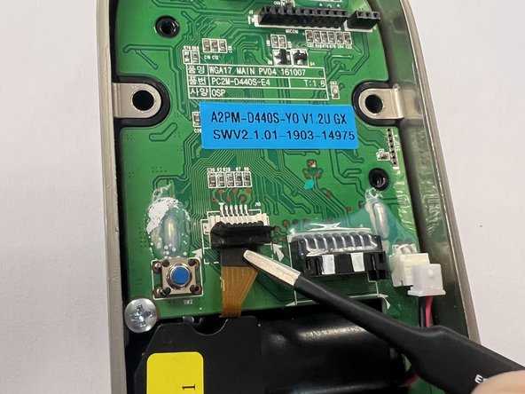

  3. Nest x Yale Lock Motherboard Replacement: crwdns2935265:03crwdnd2935265:01crwdnd2935265:01crwdne2935265:0
    • Using a pin to push down the knot holding the wire and the tweezer to safely remove the wire from the motherboard
  4. Nest x Yale Lock Motherboard Replacement: crwdns2935265:04crwdnd2935265:01crwdnd2935265:02crwdne2935265:0 Nest x Yale Lock Motherboard Replacement: crwdns2935265:04crwdnd2935265:02crwdnd2935265:02crwdne2935265:0
    • Use a spudger or plastic tool to lift the ZIF lock upward (as shown in the first picture).
    • Use tweezers to remove the ribbon cable from the motherboard.

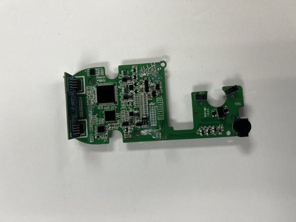

  5. Nest x Yale Lock Motherboard Replacement: crwdns2935265:05crwdnd2935265:01crwdnd2935265:01crwdne2935265:0
    • Continue to remove 2 screws holding the motherboard to the lock shell.
    • The screws are 0.20 inches in length.
  6. Nest x Yale Lock Motherboard Replacement: crwdns2935265:06crwdnd2935265:01crwdnd2935265:02crwdne2935265:0 Nest x Yale Lock Motherboard Replacement: crwdns2935265:06crwdnd2935265:02crwdnd2935265:02crwdne2935265:0
    • Use an opening tool to push the motherboard out as shown in the picture.
