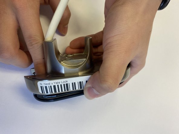

Nest x Yale Lock Keypad Replacement
If your Nest x Yale lock is related to any of the issues on the unresponsive section of your troubleshooting page, you may need to replace the touchpad. Use this guide to replace the keypad properly.
The touchpad is located inside the keypad. This touchpad is responsible for being able to input your code to unlock the door lock.
Before beginning this process, be sure that the device is off and not plugged into the lock.
    1. Nest x Yale Lock Keypad Replacement, Keypad: crwdns2935265:01crwdnd2935265:01crwdnd2935265:01crwdne2935265:0
      • Unscrew all available screws that you can see from the back.
      • The screws are 0.25 inches phillips screws.
      • Make sure to not lose any of the screws, and keep track of them.
    2. Nest x Yale Lock Keypad Replacement: crwdns2935265:02crwdnd2935265:01crwdnd2935265:01crwdne2935265:0
      • Once you have unscrewed all the screws carefully remove the metal covering.
      • Make sure that the wire safely goes through the hole.
    3. Nest x Yale Lock Keypad Replacement: crwdns2935265:03crwdnd2935265:01crwdnd2935265:01crwdne2935265:0
      • Then once again unscrew the two screws that you see.
      • The screws have a height of 0.2 inches phillips screws.
    4. Nest x Yale Lock Keypad Replacement: crwdns2935265:04crwdnd2935265:01crwdnd2935265:02crwdne2935265:0 Nest x Yale Lock Keypad Replacement: crwdns2935265:04crwdnd2935265:02crwdnd2935265:02crwdne2935265:0
      • Once all screws are unscrewed proceed to tap the screen out of the metal casing.
