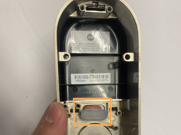

  8. Nest x Yale Lock Deadbolt Button Replacement: crwdns2935265:08crwdnd2935265:01crwdnd2935265:01crwdne2935265:0
    • Move onto removing the .25 inches screws in red to take out the battery holder.
    • Remove the .15 inches screws in orange as well.
  9. Nest x Yale Lock Deadbolt Button Replacement: crwdns2935265:09crwdnd2935265:01crwdnd2935265:02crwdne2935265:0 Nest x Yale Lock Deadbolt Button Replacement: crwdns2935265:09crwdnd2935265:02crwdnd2935265:02crwdne2935265:0
    • After unscrewing the battery holder you can now see the lights circled in red
    • The part squared in orange is a rubber that reflects the light of the LED.
