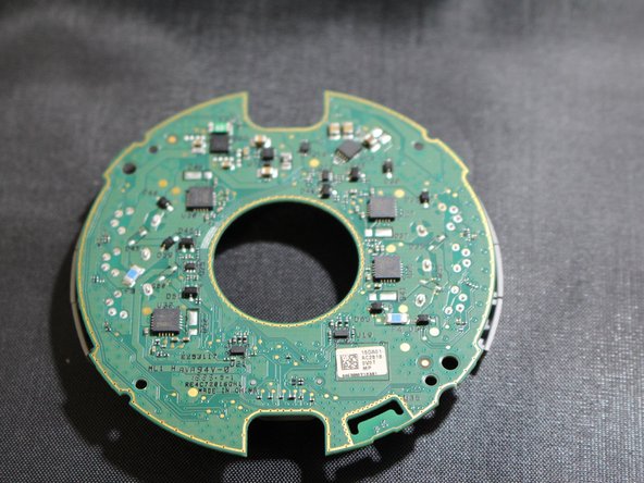

  4. Nest Thermostat E Motherboard Replacement, Motherboard: crwdns2935265:04crwdnd2935265:01crwdnd2935265:01crwdne2935265:0
    • Remove the four 6 mm screws using a Phillips #0 screwdriver.
    • The two smaller screws go around the pin connector and the two larger screws go by the outside bezel.
    • Grab the pin connector and pull up to remove the thermostat backplate from the thermostat.
  5. Nest Thermostat E Motherboard Replacement: crwdns2935265:05crwdnd2935265:01crwdnd2935265:02crwdne2935265:0 Nest Thermostat E Motherboard Replacement: crwdns2935265:05crwdnd2935265:02crwdnd2935265:02crwdne2935265:0
    • Flip the base display over and the display motherboard will remove itself from the display.
