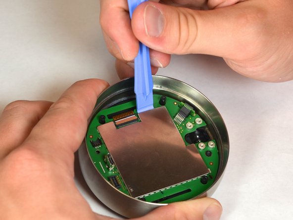

    1. Nest Learning Thermostat 2nd Generation Optical Finger Motion Sensor  Replacement, Remove screw from motherboard: crwdns2935265:011crwdnd2935265:01crwdnd2935265:01crwdne2935265:0
      • Remove the 4 mm screw from the motherboard using a #0 Phillips screwdriver.
    2. Nest Learning Thermostat 2nd Generation Optical Finger Motion Sensor  Replacement, Removal of EMI Shield: crwdns2935265:012crwdnd2935265:01crwdnd2935265:02crwdne2935265:0 Nest Learning Thermostat 2nd Generation Optical Finger Motion Sensor  Replacement, Removal of EMI Shield: crwdns2935265:012crwdnd2935265:02crwdnd2935265:02crwdne2935265:0
      • Remove the EMI shield from the motherboard using a plastic opening tool.
    3. Nest Learning Thermostat 2nd Generation Optical Finger Motion Sensor  Replacement, Disconnect the LCD ribbon: crwdns2935265:013crwdnd2935265:01crwdnd2935265:02crwdne2935265:0 Nest Learning Thermostat 2nd Generation Optical Finger Motion Sensor  Replacement, Disconnect the LCD ribbon: crwdns2935265:013crwdnd2935265:02crwdnd2935265:02crwdne2935265:0
      • Unsnap the LCD ribbon from the motherboard gently using tweezers.

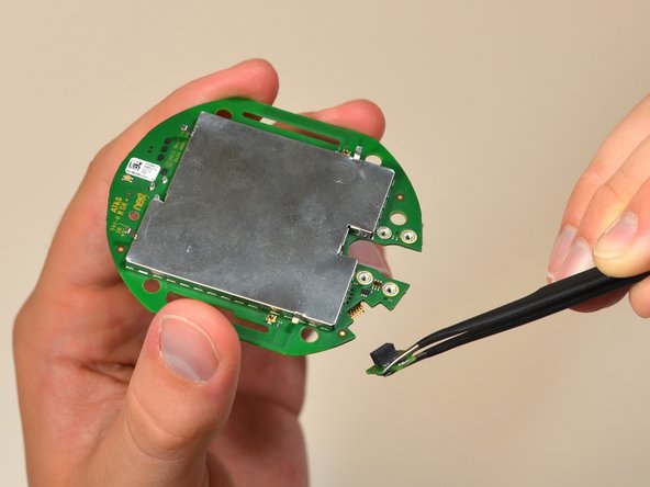

    1. Nest Learning Thermostat 2nd Generation Optical Finger Motion Sensor  Replacement, Removal of optical finger: crwdns2935265:017crwdnd2935265:01crwdnd2935265:03crwdne2935265:0 Nest Learning Thermostat 2nd Generation Optical Finger Motion Sensor  Replacement, Removal of optical finger: crwdns2935265:017crwdnd2935265:02crwdnd2935265:03crwdne2935265:0 Nest Learning Thermostat 2nd Generation Optical Finger Motion Sensor  Replacement, Removal of optical finger: crwdns2935265:017crwdnd2935265:03crwdnd2935265:03crwdne2935265:0
      • Locate the optical sensor, a small board attached at 90 degrees from the side of the motherboard.
      • Using the tweezers, grasp the small green piece of exposed board on the sensor, and pull directly away from the side of the motherboard.
