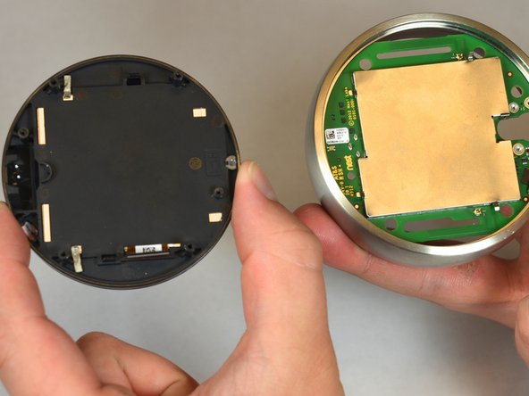

      • Grasp the display's metal outer ring with your fingers and pull directly away from the wall.
    2. Nest Learning Thermostat 2nd Generation LCD Screen Replacement, Open Display: crwdns2935265:02crwdnd2935265:01crwdnd2935265:01crwdne2935265:0
      • Turn the display over.
      • Remove the four 6 mm screws from the back of the display using a Phillips #0 screwdriver.

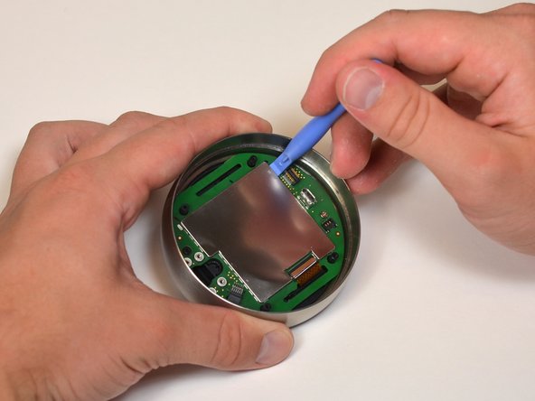

    2. Nest Learning Thermostat 2nd Generation LCD Screen Replacement, Remove EMI shield from motherboard: crwdns2935265:012crwdnd2935265:01crwdnd2935265:02crwdne2935265:0 Nest Learning Thermostat 2nd Generation LCD Screen Replacement, Remove EMI shield from motherboard: crwdns2935265:012crwdnd2935265:02crwdnd2935265:02crwdne2935265:0
      • Remove the EMI shield from the motherboard using the plastic opening tools.

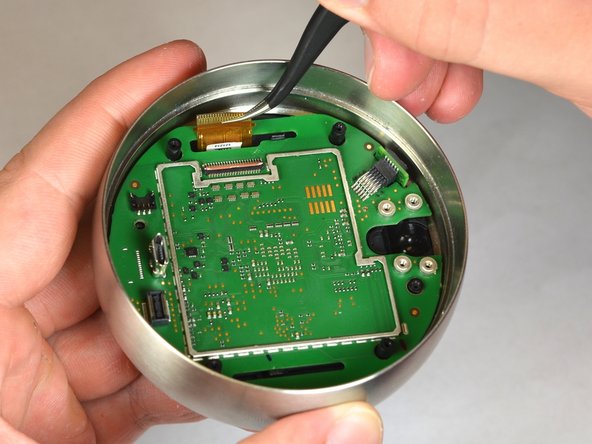

    3. Nest Learning Thermostat 2nd Generation LCD Screen Replacement, Disconnect the LCD ribbon from the motherboard: crwdns2935265:013crwdnd2935265:01crwdnd2935265:02crwdne2935265:0 Nest Learning Thermostat 2nd Generation LCD Screen Replacement, Disconnect the LCD ribbon from the motherboard: crwdns2935265:013crwdnd2935265:02crwdnd2935265:02crwdne2935265:0
      • Unsnap the LCD ribbon from the motherboard gently using the tweezers.

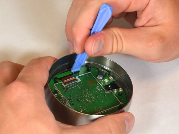

    4. Nest Learning Thermostat 2nd Generation LCD Screen Replacement, Disconnect display from motherboard: crwdns2935265:014crwdnd2935265:01crwdnd2935265:03crwdne2935265:0 Nest Learning Thermostat 2nd Generation LCD Screen Replacement, Disconnect display from motherboard: crwdns2935265:014crwdnd2935265:02crwdnd2935265:03crwdne2935265:0 Nest Learning Thermostat 2nd Generation LCD Screen Replacement, Disconnect display from motherboard: crwdns2935265:014crwdnd2935265:03crwdnd2935265:03crwdne2935265:0
      • Locate the black tabs that hold the display to the motherboard.
      • Push the black tabs gently away from the motherboard using the plastic opening tools.

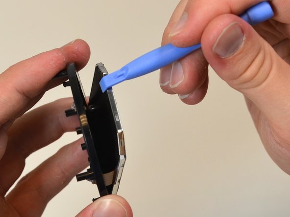

    6. Nest Learning Thermostat 2nd Generation LCD Screen Replacement, Remove bottom of display frame: crwdns2935265:016crwdnd2935265:01crwdnd2935265:03crwdne2935265:0 Nest Learning Thermostat 2nd Generation LCD Screen Replacement, Remove bottom of display frame: crwdns2935265:016crwdnd2935265:02crwdnd2935265:03crwdne2935265:0 Nest Learning Thermostat 2nd Generation LCD Screen Replacement, Remove bottom of display frame: crwdns2935265:016crwdnd2935265:03crwdnd2935265:03crwdne2935265:0
      • The front of the glass display and plastic frame is held together by only light adhesive.
      • Push the crescent shape bottom of the display away from the plastic frame using the plastic opening tools.
    7. Nest Learning Thermostat 2nd Generation LCD Screen Replacement: crwdns2935265:017crwdnd2935265:01crwdnd2935265:01crwdne2935265:0
      • Pry the front glass and plastic frame apart gently using the plastic opening tools.

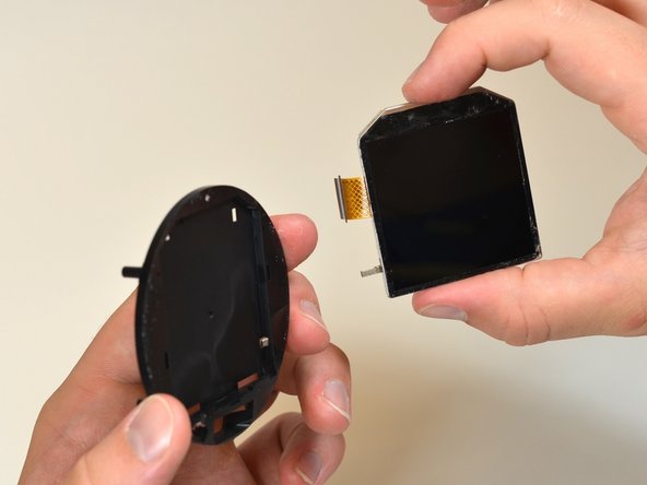

    8. Nest Learning Thermostat 2nd Generation LCD Screen Replacement, Remove LCD screen from plastic frame: crwdns2935265:018crwdnd2935265:01crwdnd2935265:02crwdne2935265:0 Nest Learning Thermostat 2nd Generation LCD Screen Replacement, Remove LCD screen from plastic frame: crwdns2935265:018crwdnd2935265:02crwdnd2935265:02crwdne2935265:0
      • Pry the LCD screen gently from the plastic frame using the plastic opening tools.
    9. Nest Learning Thermostat 2nd Generation LCD Screen Replacement, Separate LCD from frame: crwdns2935265:019crwdnd2935265:01crwdnd2935265:03crwdne2935265:0 Nest Learning Thermostat 2nd Generation LCD Screen Replacement, Separate LCD from frame: crwdns2935265:019crwdnd2935265:02crwdnd2935265:03crwdne2935265:0 Nest Learning Thermostat 2nd Generation LCD Screen Replacement, Separate LCD from frame: crwdns2935265:019crwdnd2935265:03crwdnd2935265:03crwdne2935265:0
      • Pull the LCD screen away from the plastic frame gently using your fingers.

Skip step 12. There is no reason to remove the EMI shield.
richardrobison - crwdns2934203:0crwdne2934203:0 crwdns2950251:0crwdne2950251:0
