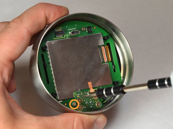

  8. Nest Learning Thermostat 2nd Generation Auto-Away Sensor Replacement, Locate auto-away sensor: crwdns2935265:08crwdnd2935265:01crwdnd2935265:01crwdne2935265:0
    • Locate the auto-away sensor.
  9. Nest Learning Thermostat 2nd Generation Auto-Away Sensor Replacement, Remove screws: crwdns2935265:09crwdnd2935265:01crwdnd2935265:02crwdne2935265:0 Nest Learning Thermostat 2nd Generation Auto-Away Sensor Replacement, Remove screws: crwdns2935265:09crwdnd2935265:02crwdnd2935265:02crwdne2935265:0
    • Remove the four 3mm screws with a #0 Phillips screwdriver.
    • Remove the one 4mm screw located at the edge of the auto-away sensor. Use a #0 Phillips screwdriver.

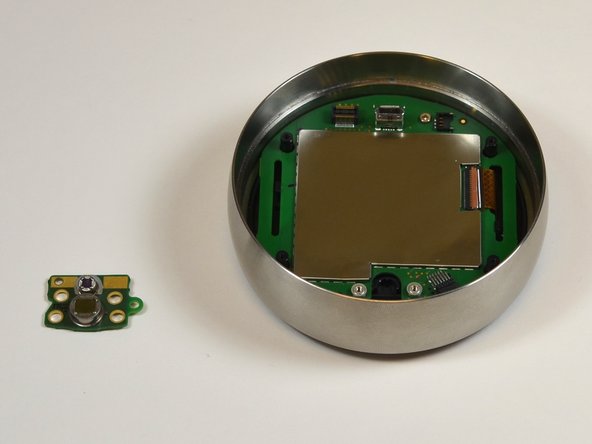

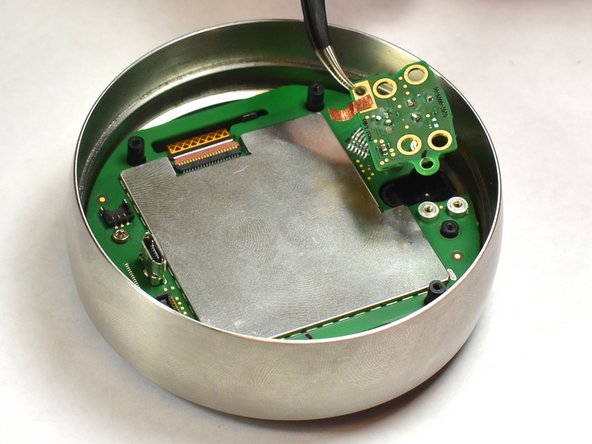

  10. Nest Learning Thermostat 2nd Generation Auto-Away Sensor Replacement, Remove auto-away sensor: crwdns2935265:010crwdnd2935265:01crwdnd2935265:03crwdne2935265:0 Nest Learning Thermostat 2nd Generation Auto-Away Sensor Replacement, Remove auto-away sensor: crwdns2935265:010crwdnd2935265:02crwdnd2935265:03crwdne2935265:0 Nest Learning Thermostat 2nd Generation Auto-Away Sensor Replacement, Remove auto-away sensor: crwdns2935265:010crwdnd2935265:03crwdnd2935265:03crwdne2935265:0
    • Lift the auto-away sensor from motherboard using tweezers.
    • Peel the copper foil gently from the EMI shield.
