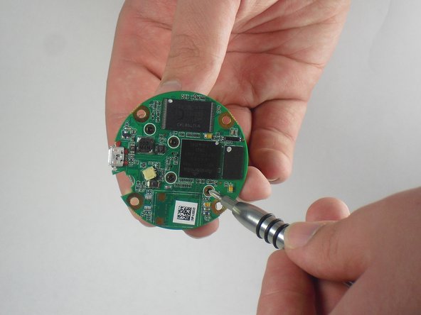

  6. Nest Dropcam Pro Micro-USB Port Replacement: crwdns2935265:06crwdnd2935265:01crwdnd2935265:02crwdne2935265:0 Nest Dropcam Pro Micro-USB Port Replacement: crwdns2935265:06crwdnd2935265:02crwdnd2935265:02crwdne2935265:0
    • Using a Philips #0 screwdriver, remove the four 2 mm screws.

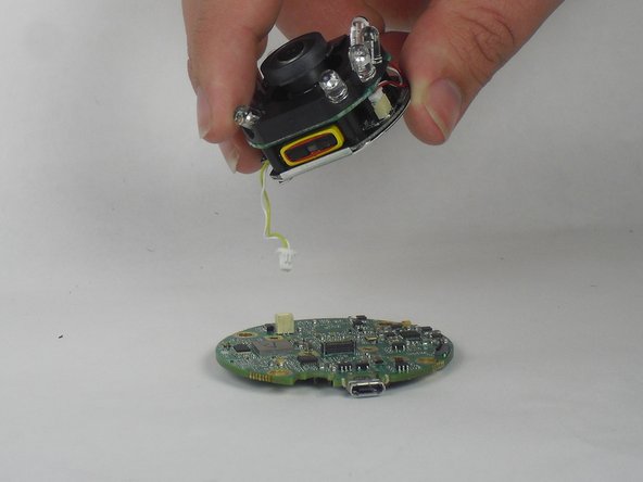

    • Lift the lens and LED assembly away from the motherboard.
    • Unplug the yellow and white cable from the motherboard.
