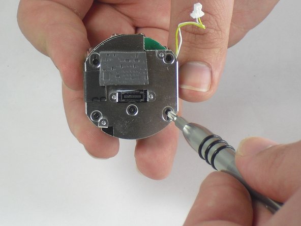

    1. Nest Dropcam Pro Camera Lens Replacement, Camera Lens: crwdns2935265:08crwdnd2935265:01crwdnd2935265:02crwdne2935265:0 Nest Dropcam Pro Camera Lens Replacement, Camera Lens: crwdns2935265:08crwdnd2935265:02crwdnd2935265:02crwdne2935265:0
      • Using a Philips #0 screwdriver, remove the four 2 mm screws.
    2. Nest Dropcam Pro Camera Lens Replacement: crwdns2935265:09crwdnd2935265:01crwdnd2935265:03crwdne2935265:0 Nest Dropcam Pro Camera Lens Replacement: crwdns2935265:09crwdnd2935265:02crwdnd2935265:03crwdne2935265:0 Nest Dropcam Pro Camera Lens Replacement: crwdns2935265:09crwdnd2935265:03crwdnd2935265:03crwdne2935265:0
      • Peel off the paper seal holding the Lens and LEDs together.
      • Disconnect the red and white wire from the bottom board.

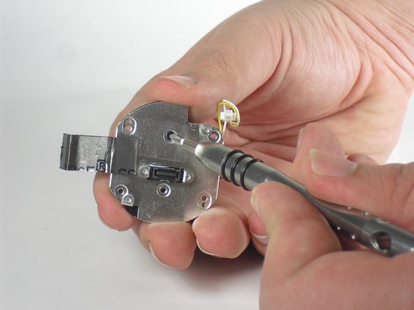

    3. Nest Dropcam Pro Camera Lens Replacement: crwdns2935265:010crwdnd2935265:01crwdnd2935265:02crwdne2935265:0 Nest Dropcam Pro Camera Lens Replacement: crwdns2935265:010crwdnd2935265:02crwdnd2935265:02crwdne2935265:0
      • Lift up the foam cover to reveal a second screw underneath.
      • Using a Philips #0 screwdriver, remove the two 3 mm screws.
    4. Nest Dropcam Pro Camera Lens Replacement: crwdns2935265:011crwdnd2935265:01crwdnd2935265:01crwdne2935265:0
      • With the screws gone, lift the camera lens away from the remaining components.
