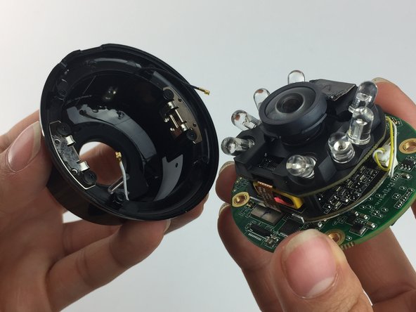

    • Remove the four 6 mm screws from the back panel with the J000 Phillips head screwdriver.
    • We suggest designated areas to keep track of all screws.
  2. Nest Cam Wi-Fi Cable Replacement: crwdns2935265:02crwdnd2935265:01crwdnd2935265:03crwdne2935265:0 Nest Cam Wi-Fi Cable Replacement: crwdns2935265:02crwdnd2935265:02crwdnd2935265:03crwdne2935265:0 Nest Cam Wi-Fi Cable Replacement: crwdns2935265:02crwdnd2935265:03crwdnd2935265:03crwdne2935265:0
    • Open the back panel completely to expose the inside of the Nest Cam.
    • Using the tweezers, disconnect the red and black mic cable from the motherboard.
  3. Nest Cam Wi-Fi Cable Replacement: crwdns2935265:03crwdnd2935265:01crwdnd2935265:03crwdne2935265:0 Nest Cam Wi-Fi Cable Replacement: crwdns2935265:03crwdnd2935265:02crwdnd2935265:03crwdne2935265:0 Nest Cam Wi-Fi Cable Replacement: crwdns2935265:03crwdnd2935265:03crwdnd2935265:03crwdne2935265:0
    • Disconnect the black Wi-Fi cable from the top of the motherboard with tweezers.
    • Use a plastic spudger to lift the motherboard and camera up enough to expose and disconnect the white cable with the tweezers.
    • Remove motherboard and camera completely from the housing.
  4. Nest Cam Wi-Fi Cable Replacement: crwdns2935265:04crwdnd2935265:01crwdnd2935265:01crwdne2935265:0
    • Using a soldering iron, melt away the base of the Wi-Fi cable until it can be removed. Use this guild for assistance with soldering.
    • Ensure when you solder the new cable back on that all connector ends are positioned correctly.
