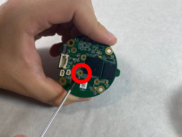

  6. Nest Cam Outdoor S Motherboard Replacement: crwdns2935265:06crwdnd2935265:01crwdnd2935265:01crwdne2935265:0
    • Remove the four mounting screws from the motherboard.

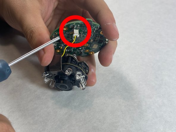

  7. Nest Cam Outdoor S Motherboard Replacement: crwdns2935265:07crwdnd2935265:01crwdnd2935265:01crwdne2935265:0
    • Disconnect the yellow camera cable from the motherboard.
    • Remove the motherboard from the device.
