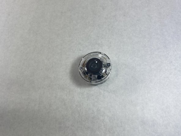

    • Wedge a spudger between the black front panel and the white outer shell.
    • Slide the spudger around the edge of the panel to pop it off.
  2. Nest Cam Outdoor S Battery Replacement: crwdns2935265:02crwdnd2935265:01crwdnd2935265:01crwdne2935265:0
    • Remove the four small screws from the plastic camera cover.
  3. Nest Cam Outdoor S Battery Replacement: crwdns2935265:03crwdnd2935265:01crwdnd2935265:01crwdne2935265:0

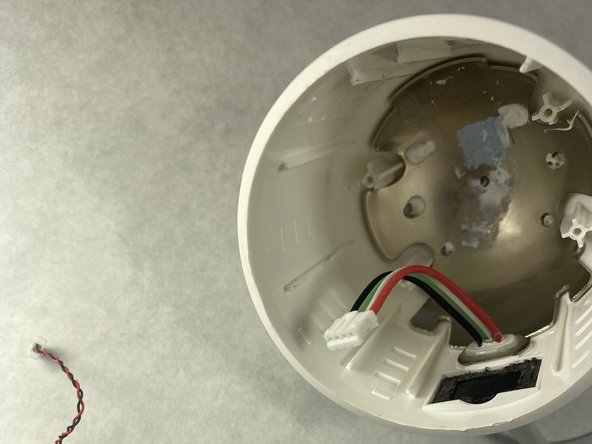

    • Disconnect the microphone cable to separate the motherboard from the main camera unit.
  4. Nest Cam Outdoor S Battery Replacement: crwdns2935265:04crwdnd2935265:01crwdnd2935265:02crwdne2935265:0 Nest Cam Outdoor S Battery Replacement: crwdns2935265:04crwdnd2935265:02crwdnd2935265:02crwdne2935265:0
    • Remove the plastic camera cover from the device.
  5. Nest Cam Outdoor S Battery Replacement, Battery: crwdns2935265:05crwdnd2935265:01crwdnd2935265:02crwdne2935265:0 Nest Cam Outdoor S Battery Replacement, Battery: crwdns2935265:05crwdnd2935265:02crwdnd2935265:02crwdne2935265:0
    • Wedge a nylon spudger between the white outer shell and the battery.
    • Slowly pull the battery away from the plastic camera cover.
    • The battery is only held on with glue.
