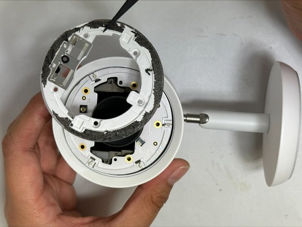

    • To soften the adhesive holding the camera together, heat up the edges of the glass lens using a heated iOpener on the device. Alternatively, you can use a heat gun to loosen the adhesive.
    • Leave the Opener on the glass lens for two minutes.
    • Be careful not to burn yourself while handling the hot iOpener. For more information on the Opener, use the iOpener Instructions Guide.
  2. Nest Cam IQ Mounting Stand Replacement: crwdns2935265:02crwdnd2935265:01crwdnd2935265:01crwdne2935265:0
    • Use an opening tool to split apart the glass lens from the body.
    • Be careful to not break the glass when prying from the body.

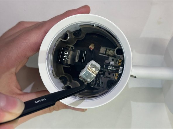

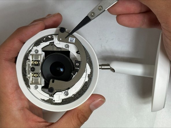

  4. Nest Cam IQ Mounting Stand Replacement: crwdns2935265:04crwdnd2935265:01crwdnd2935265:02crwdne2935265:0 Nest Cam IQ Mounting Stand Replacement: crwdns2935265:04crwdnd2935265:02crwdnd2935265:02crwdne2935265:0

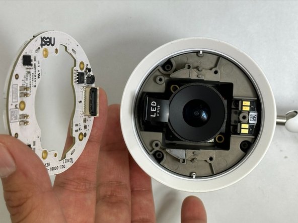

    • Carefully disconnect the flat black ribbon cable connecting the metal plate to the LED.
    • Remove the metal plate.
  5. Nest Cam IQ Mounting Stand Replacement: crwdns2935265:05crwdnd2935265:01crwdnd2935265:02crwdne2935265:0 Nest Cam IQ Mounting Stand Replacement: crwdns2935265:05crwdnd2935265:02crwdnd2935265:02crwdne2935265:0

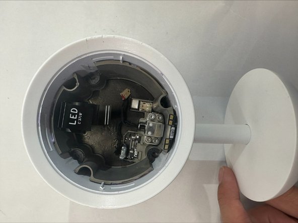

    • Remove the five 9mm TR6 Torx screws from the LED cover.
    • Pull off the LED cover.
    • As you remove the LED cover, be careful not to tear the flat black ribbon connecting the LED to the motherboard.

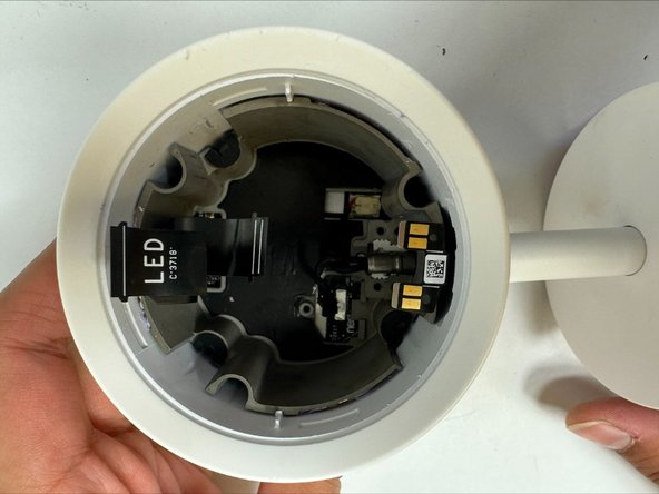

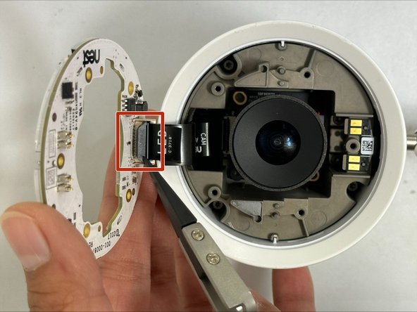

  6. Nest Cam IQ Mounting Stand Replacement: crwdns2935265:06crwdnd2935265:01crwdnd2935265:03crwdne2935265:0 Nest Cam IQ Mounting Stand Replacement: crwdns2935265:06crwdnd2935265:02crwdnd2935265:03crwdne2935265:0 Nest Cam IQ Mounting Stand Replacement: crwdns2935265:06crwdnd2935265:03crwdnd2935265:03crwdne2935265:0
    • Carefully disconnect the flat black ribbon cable connecting the LED to the motherboard.
    • Remove the LED cover.

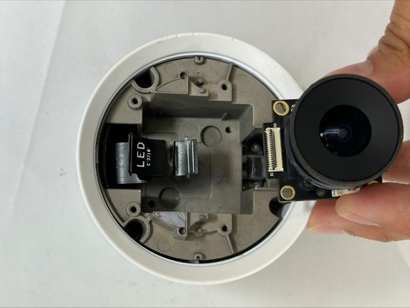

  7. Nest Cam IQ Mounting Stand Replacement: crwdns2935265:07crwdnd2935265:01crwdnd2935265:01crwdne2935265:0
    • Remove the two 7mm TR6 Torx screws securing the camera.
    • Carefully pull out the camera.
    • As you remove the camera, be careful not to tear the flat black ribbon connecting the camera to the motherboard.
  8. Nest Cam IQ Mounting Stand Replacement: crwdns2935265:08crwdnd2935265:01crwdnd2935265:02crwdne2935265:0 Nest Cam IQ Mounting Stand Replacement: crwdns2935265:08crwdnd2935265:02crwdnd2935265:02crwdne2935265:0
    • Carefully disconnect the flat black ribbon cable connecting the camera to the motherboard.
    • Remove the camera.

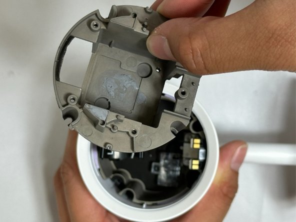

  9. Nest Cam IQ Mounting Stand Replacement: crwdns2935265:09crwdnd2935265:01crwdnd2935265:03crwdne2935265:0 Nest Cam IQ Mounting Stand Replacement: crwdns2935265:09crwdnd2935265:02crwdnd2935265:03crwdne2935265:0 Nest Cam IQ Mounting Stand Replacement: crwdns2935265:09crwdnd2935265:03crwdnd2935265:03crwdne2935265:0
    • Remove the three 19mm TR6 Torx screws from the camera holder.
    • Carefully lift the tab up and away from the camera holder.
    • Remove the camera holder.

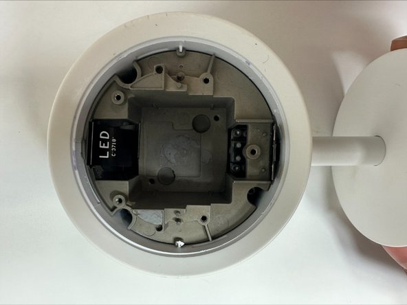

  11. Nest Cam IQ Mounting Stand Replacement: crwdns2935265:011crwdnd2935265:01crwdnd2935265:03crwdne2935265:0 Nest Cam IQ Mounting Stand Replacement: crwdns2935265:011crwdnd2935265:02crwdnd2935265:03crwdne2935265:0 Nest Cam IQ Mounting Stand Replacement: crwdns2935265:011crwdnd2935265:03crwdnd2935265:03crwdne2935265:0
    • Remove the four 11mm TR6 Torx screws from the clamp securing the mounting stand.
    • Remove the clamp.
    • Carefully pull away the cables connecting the mounting stand to the body.
  12. Nest Cam IQ Mounting Stand Replacement: crwdns2935265:012crwdnd2935265:01crwdnd2935265:01crwdne2935265:0
    • Carefully remove the mounting stand.
