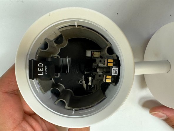

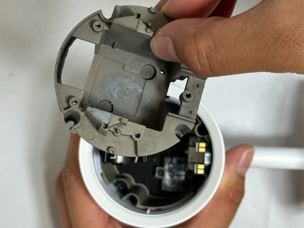

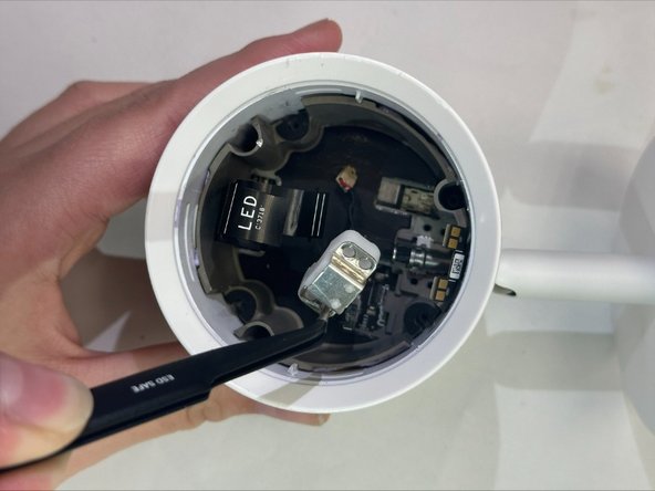

  4. Nest Cam IQ Motherboard Replacement: crwdns2935265:04crwdnd2935265:01crwdnd2935265:02crwdne2935265:0 Nest Cam IQ Motherboard Replacement: crwdns2935265:04crwdnd2935265:02crwdnd2935265:02crwdne2935265:0

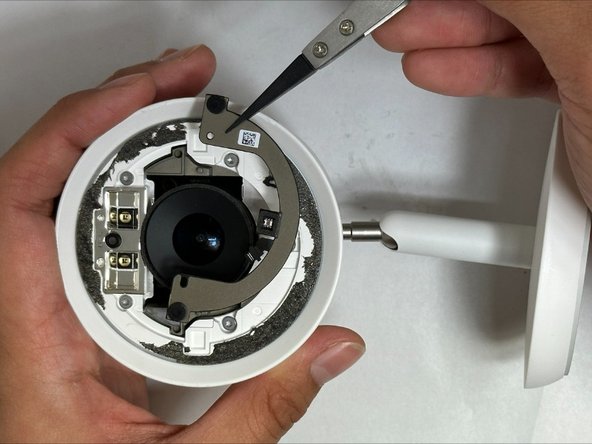

    • Carefully disconnect the flat black ribbon cable connecting the metal plate to the LED.
    • Remove the metal plate.
  5. Nest Cam IQ Motherboard Replacement: crwdns2935265:05crwdnd2935265:01crwdnd2935265:02crwdne2935265:0 Nest Cam IQ Motherboard Replacement: crwdns2935265:05crwdnd2935265:02crwdnd2935265:02crwdne2935265:0

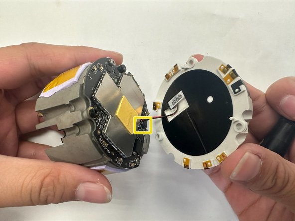

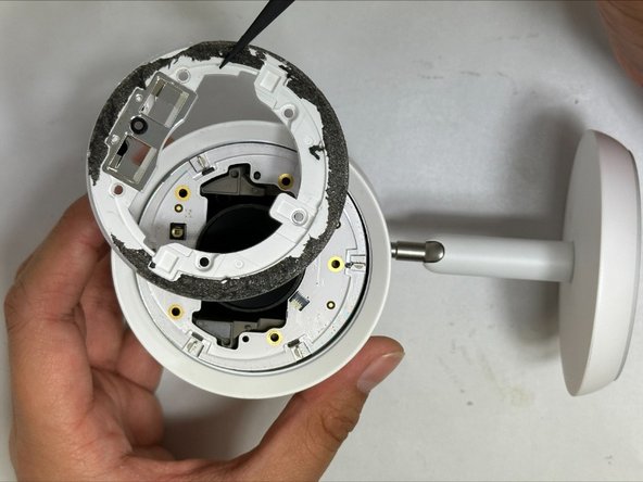

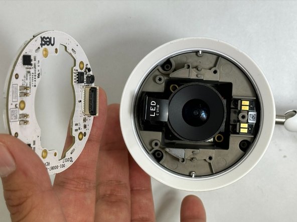

    • Remove the five 9 mm TR6 Torx screws from the LED cover.
    • Pull off the LED cover.
    • As you remove the LED cover, be careful not to tear the flat black ribbon connecting the LED to the motherboard.
  6. Nest Cam IQ Motherboard Replacement: crwdns2935265:06crwdnd2935265:01crwdnd2935265:03crwdne2935265:0 Nest Cam IQ Motherboard Replacement: crwdns2935265:06crwdnd2935265:02crwdnd2935265:03crwdne2935265:0 Nest Cam IQ Motherboard Replacement: crwdns2935265:06crwdnd2935265:03crwdnd2935265:03crwdne2935265:0
    • Carefully disconnect the flat black ribbon cable connecting the LED to the motherboard.
    • Remove the LED cover.

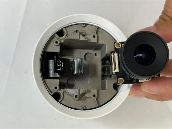

  7. Nest Cam IQ Motherboard Replacement: crwdns2935265:07crwdnd2935265:01crwdnd2935265:01crwdne2935265:0
    • Remove the two 7 mm TR6 Torx screws securing the camera.
    • Carefully pull out the camera.
    • As you remove the camera, be careful not to tear the flat black ribbon connecting the camera to the motherboard.
  8. Nest Cam IQ Motherboard Replacement: crwdns2935265:08crwdnd2935265:01crwdnd2935265:02crwdne2935265:0 Nest Cam IQ Motherboard Replacement: crwdns2935265:08crwdnd2935265:02crwdnd2935265:02crwdne2935265:0
    • Carefully disconnect the flat black ribbon cable connecting the camera to the motherboard.
    • Remove the camera.

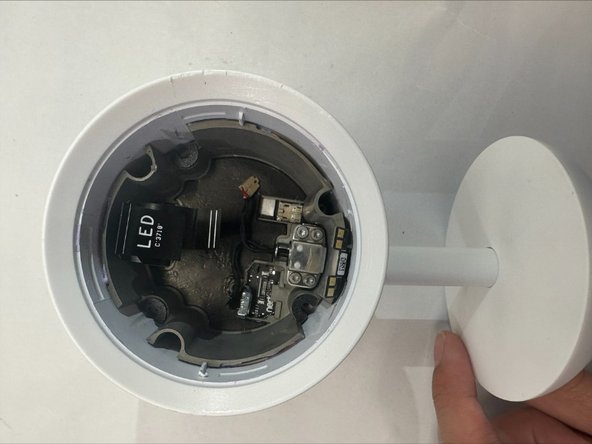

  9. Nest Cam IQ Motherboard Replacement: crwdns2935265:09crwdnd2935265:01crwdnd2935265:03crwdne2935265:0 Nest Cam IQ Motherboard Replacement: crwdns2935265:09crwdnd2935265:02crwdnd2935265:03crwdne2935265:0 Nest Cam IQ Motherboard Replacement: crwdns2935265:09crwdnd2935265:03crwdnd2935265:03crwdne2935265:0
    • Remove the three 19 mm TR6 Torx screws from the camera holder.
    • Carefully lift the tab up and away from the camera holder.
    • Remove the camera holder.

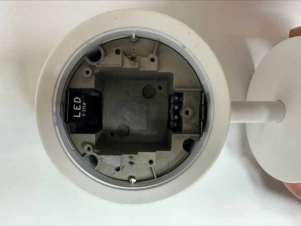

  10. Nest Cam IQ Motherboard Replacement: crwdns2935265:010crwdnd2935265:01crwdnd2935265:02crwdne2935265:0 Nest Cam IQ Motherboard Replacement: crwdns2935265:010crwdnd2935265:02crwdnd2935265:02crwdne2935265:0
    • Remove the one 4 mm TR6 Torx screw from the clear cover.
    • Remove the clear cover.

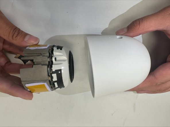

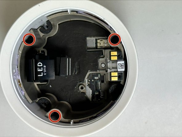

  12. Nest Cam IQ Motherboard Replacement: crwdns2935265:012crwdnd2935265:01crwdnd2935265:03crwdne2935265:0 Nest Cam IQ Motherboard Replacement: crwdns2935265:012crwdnd2935265:02crwdnd2935265:03crwdne2935265:0 Nest Cam IQ Motherboard Replacement: crwdns2935265:012crwdnd2935265:03crwdnd2935265:03crwdne2935265:0
    • Carefully remove the mounting stand.
    • Remove the three 9 mm TR6 Torx connecting the motherboard and speaker to the body.
    • Pull the motherboard and speaker from the body.

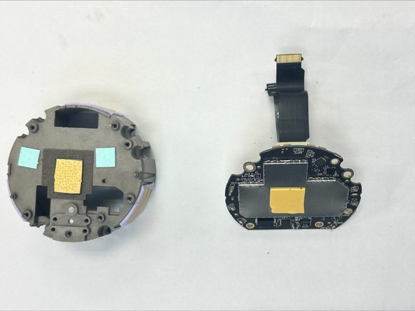

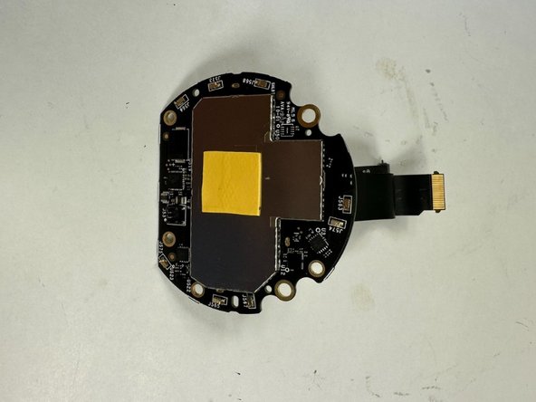

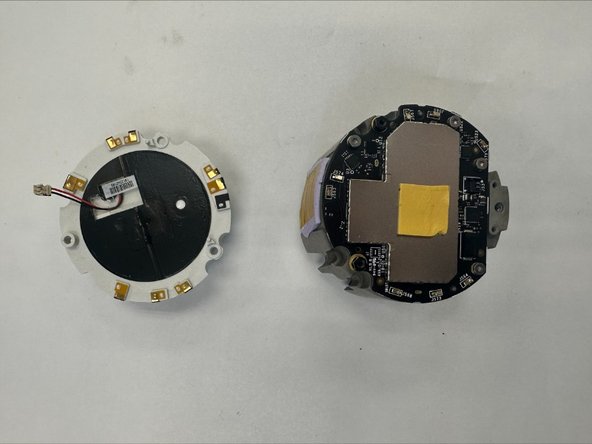

  14. Nest Cam IQ Motherboard Replacement: crwdns2935265:014crwdnd2935265:01crwdnd2935265:03crwdne2935265:0 Nest Cam IQ Motherboard Replacement: crwdns2935265:014crwdnd2935265:02crwdnd2935265:03crwdne2935265:0 Nest Cam IQ Motherboard Replacement: crwdns2935265:014crwdnd2935265:03crwdnd2935265:03crwdne2935265:0
    • Remove the four 4 mm TR6 Torx screws securing the motherboard.
    • Remove the two 5 mm 3.5 low-head socket cap screws securing the motherboard.
    • Remove the motherboard.
