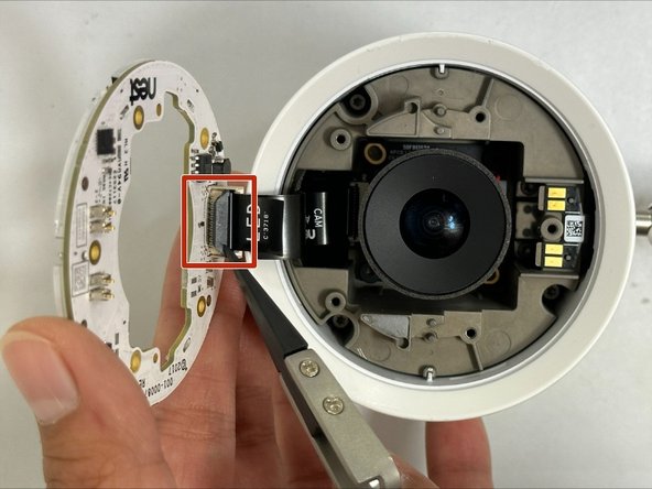

  4. Nest Cam IQ Camera Replacement: crwdns2935265:04crwdnd2935265:01crwdnd2935265:02crwdne2935265:0 Nest Cam IQ Camera Replacement: crwdns2935265:04crwdnd2935265:02crwdnd2935265:02crwdne2935265:0
    • Carefully disconnect the flat black ribbon cable connecting the metal plate to the LED.
    • Remove the metal plate.

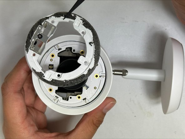

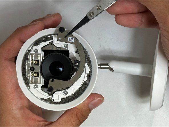

  5. Nest Cam IQ Camera Replacement: crwdns2935265:05crwdnd2935265:01crwdnd2935265:02crwdne2935265:0 Nest Cam IQ Camera Replacement: crwdns2935265:05crwdnd2935265:02crwdnd2935265:02crwdne2935265:0
    • Remove the five 9 mm TR6 Torx screws from the LED cover.
    • Pull off the LED cover.
    • As you remove the LED cover, be careful not to tear the flat black ribbon connecting the LED to the motherboard.

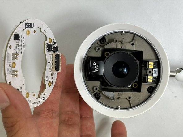

  6. Nest Cam IQ Camera Replacement: crwdns2935265:06crwdnd2935265:01crwdnd2935265:03crwdne2935265:0 Nest Cam IQ Camera Replacement: crwdns2935265:06crwdnd2935265:02crwdnd2935265:03crwdne2935265:0 Nest Cam IQ Camera Replacement: crwdns2935265:06crwdnd2935265:03crwdnd2935265:03crwdne2935265:0
    • Carefully disconnect the flat black ribbon cable connecting the LED to the motherboard.
    • Remove the LED cover.

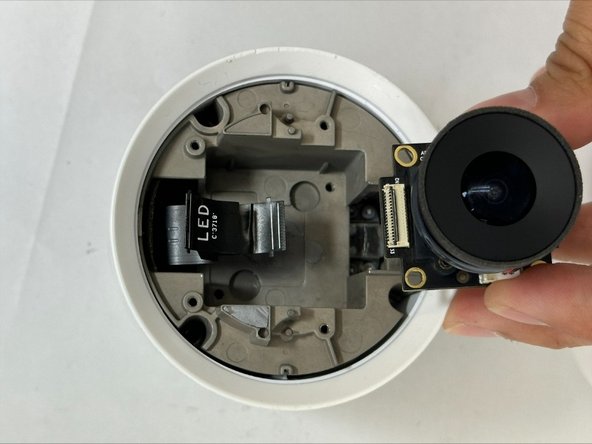

  7. Nest Cam IQ Camera Replacement: crwdns2935265:07crwdnd2935265:01crwdnd2935265:01crwdne2935265:0
    • Remove the two 7 mm TR6 Torx screws securing the camera.
    • Carefully pull out the camera.
    • As you remove the camera, be careful not to tear the flat black ribbon connecting the camera to the motherboard.
  8. Nest Cam IQ Camera Replacement: crwdns2935265:08crwdnd2935265:01crwdnd2935265:02crwdne2935265:0 Nest Cam IQ Camera Replacement: crwdns2935265:08crwdnd2935265:02crwdnd2935265:02crwdne2935265:0
    • Carefully disconnect the flat black ribbon cable connecting the camera to the motherboard.
    • Remove the camera.
