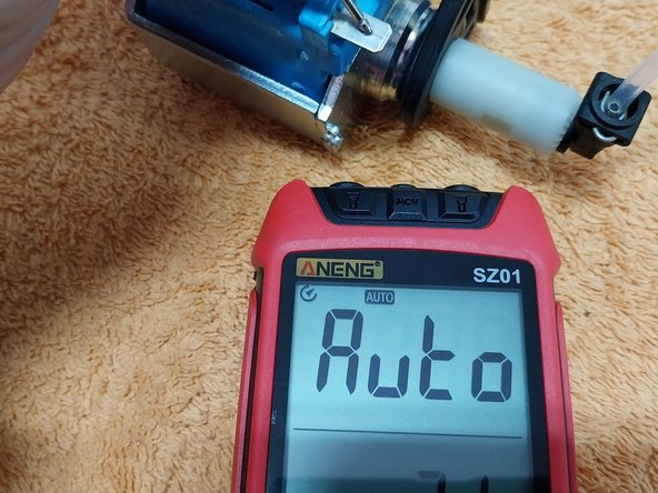

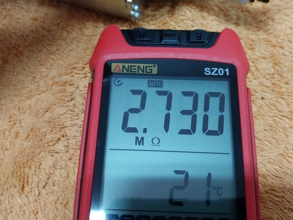

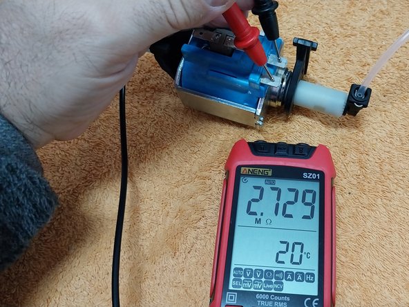

    • Repeat the tests using an automatic/autoscale multimeter. Yous will find that the readings might vary wildly.
    • Picture 2: The measurement shown is 2,729 Mohms

    • Pictures on detail of the measurement
  6. Nespresso/Nescafé Dolce Gusto water pump functionality check: crwdns2935265:06crwdnd2935265:01crwdnd2935265:02crwdne2935265:0 Nespresso/Nescafé Dolce Gusto water pump functionality check: crwdns2935265:06crwdnd2935265:02crwdnd2935265:02crwdne2935265:0
    • By changing direction of the probes we can see that, similarly to what happened in the first multimeter, we still do not get the measurement AUTO = open circuit.
  7. Nespresso/Nescafé Dolce Gusto water pump functionality check: crwdns2935265:07crwdnd2935265:01crwdnd2935265:02crwdne2935265:0 Nespresso/Nescafé Dolce Gusto water pump functionality check: crwdns2935265:07crwdnd2935265:02crwdnd2935265:02crwdne2935265:0

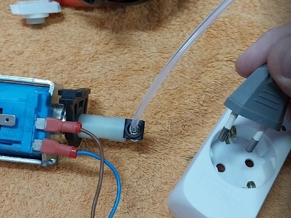

    • The multimeter reading has given us the correct measurement. Supplying the pump motor directly from mains power will not be necessary, but if you want to double-check it, you can try it.
    • We need a cable with the correct adapter for our location and 2 "FASTON" connectors.
    • When the cable is plugged into mains and the motor, the pump should vibrate and make the same noise that we hear when making a coffee to indicate that the water pump is functioning. Keep in mind that since the pump is not connected to water, it will may overheat and burn out if you run the test for longer than 5-8 seconds.
    • With all of this done, we have ensured that the pump is in working order.
