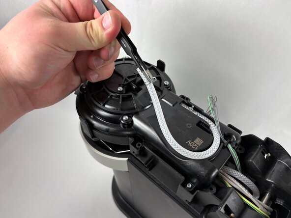

  5. Nespresso Vertuo Next Upper Water Line Replacement, Upper Water Line: crwdns2935265:05crwdnd2935265:01crwdnd2935265:02crwdne2935265:0 Nespresso Vertuo Next Upper Water Line Replacement, Upper Water Line: crwdns2935265:05crwdnd2935265:02crwdnd2935265:02crwdne2935265:0
    • Use tweezers to remove the clip at the end of the upper water line.
    • Note: You may have to grasp with your other hand and pull the line with your other in order to remove the clip.

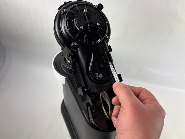

  6. Nespresso Vertuo Next Upper Water Line Replacement: crwdns2935265:06crwdnd2935265:01crwdnd2935265:02crwdne2935265:0 Nespresso Vertuo Next Upper Water Line Replacement: crwdns2935265:06crwdnd2935265:02crwdnd2935265:02crwdne2935265:0
    • For the second clip on the lower part of the line, repeat the previous step. After the removal of the second clip, the remove the line.
