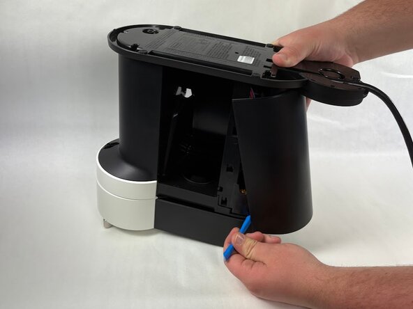

  1. Nespresso Vertuo Next Lower Water Line Replacement, Water Pump: crwdns2935265:01crwdnd2935265:01crwdnd2935265:03crwdne2935265:0 Nespresso Vertuo Next Lower Water Line Replacement, Water Pump: crwdns2935265:01crwdnd2935265:02crwdnd2935265:03crwdne2935265:0 Nespresso Vertuo Next Lower Water Line Replacement, Water Pump: crwdns2935265:01crwdnd2935265:03crwdnd2935265:03crwdne2935265:0

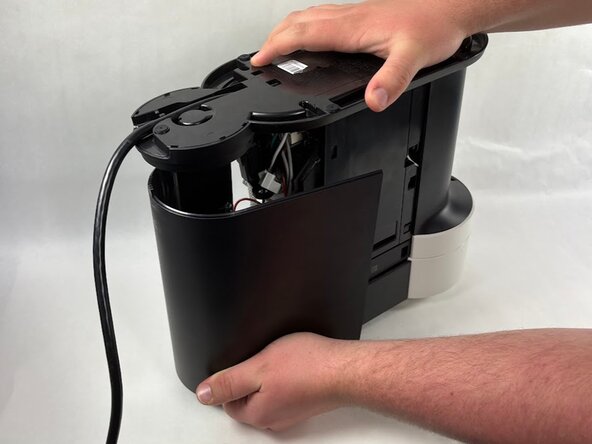

    • Insert an opening tool in the seams between the rear panel and chassis.
    • Pry off the rear panel.
    • You may need multiple opening tools at once in order to open the device panel.

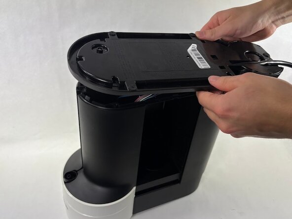

    • Remove the four 13.5 mm screws on the base plate using a T18 Torx screwdriver.

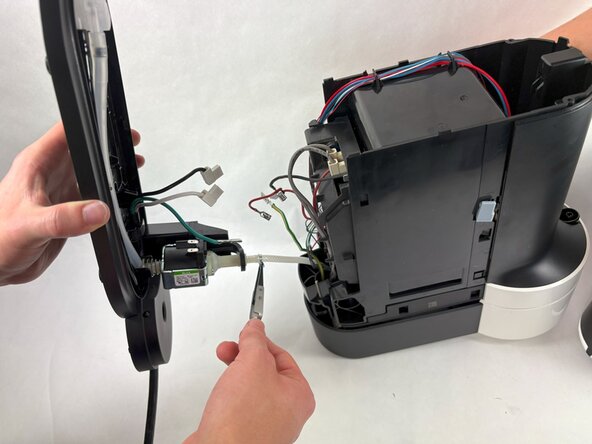

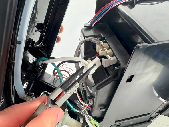

  3. Nespresso Vertuo Next Lower Water Line Replacement: crwdns2935265:03crwdnd2935265:01crwdnd2935265:03crwdne2935265:0 Nespresso Vertuo Next Lower Water Line Replacement: crwdns2935265:03crwdnd2935265:02crwdnd2935265:03crwdne2935265:0 Nespresso Vertuo Next Lower Water Line Replacement: crwdns2935265:03crwdnd2935265:03crwdnd2935265:03crwdne2935265:0

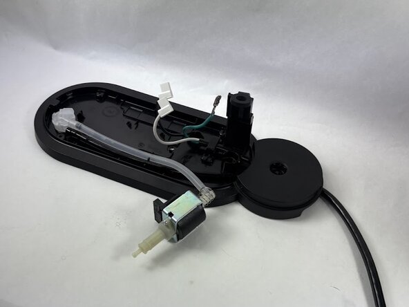

    • With tweezers, pinch one half of each connected pair of wires, and then gently pull and disconnect the wires.
    • Use a pair of tweezers to clamp down and disconnect the water line connecting to the base plate of the machine.
    • Remove the base plate from device
    • Wires can be fragile, handle with care.

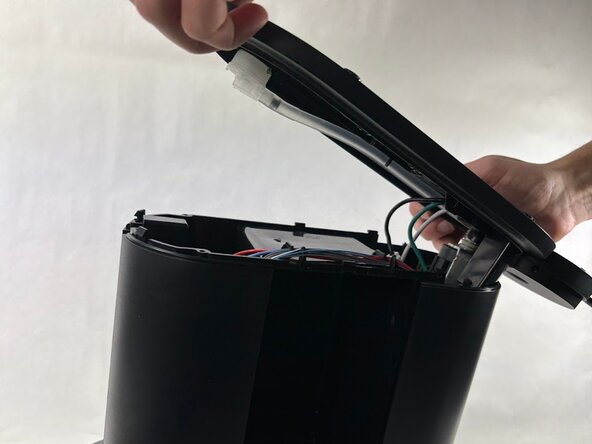

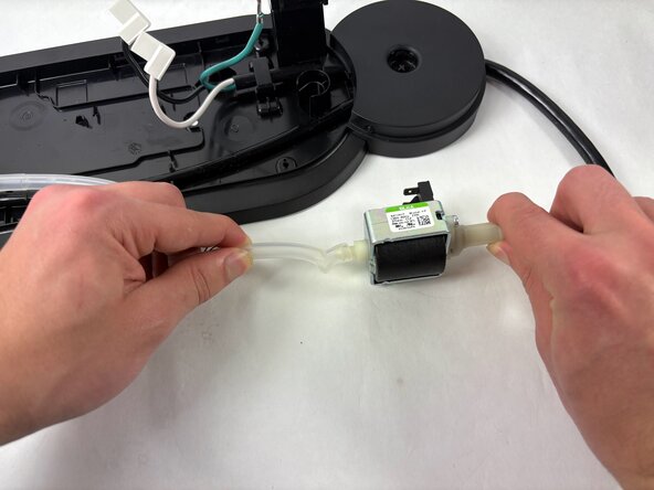

    • Remove the rubber hoop connecting the motor to the base.
    • Lift the motor off of baseplate and pull waterline away from the base.

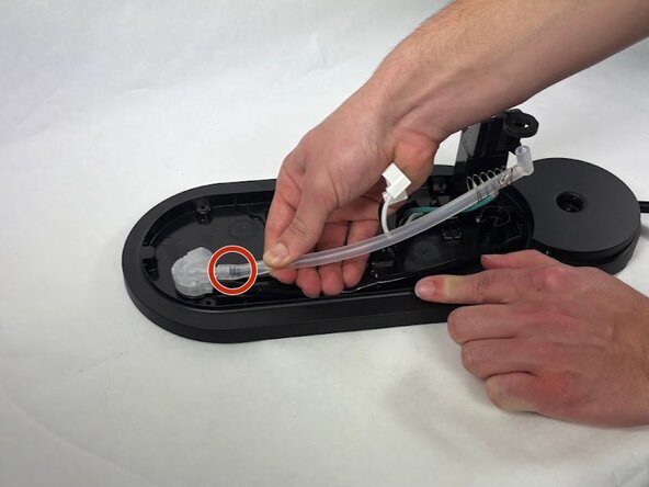

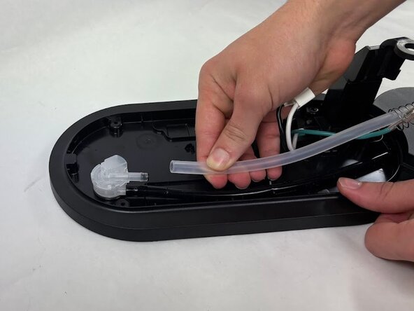

  5. Nespresso Vertuo Next Lower Water Line Replacement, Lower Water Line: crwdns2935265:05crwdnd2935265:01crwdnd2935265:03crwdne2935265:0 Nespresso Vertuo Next Lower Water Line Replacement, Lower Water Line: crwdns2935265:05crwdnd2935265:02crwdnd2935265:03crwdne2935265:0 Nespresso Vertuo Next Lower Water Line Replacement, Lower Water Line: crwdns2935265:05crwdnd2935265:03crwdnd2935265:03crwdne2935265:0
    • Remove the waterline from the clear water hub by pulling on the end of the line that connects to the main hub at the base.
    • Ensure that you pull tightly on the line in order to remove it
