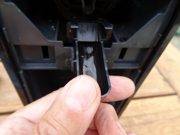

  4. Nespresso U inner coffee spout replacement: crwdns2935265:04crwdnd2935265:01crwdnd2935265:02crwdne2935265:0 Nespresso U inner coffee spout replacement: crwdns2935265:04crwdnd2935265:02crwdnd2935265:02crwdne2935265:0
    • Now you can lift out the defective inner coffee spout. Its retaining tabs are probably broken off, so this should be quite easy.

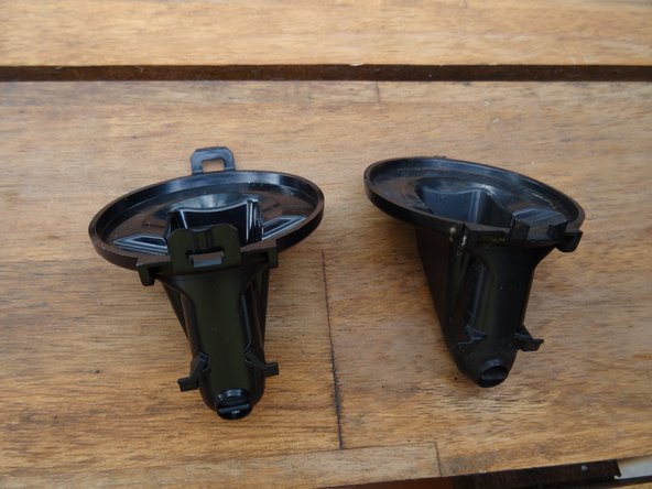

  5. Nespresso U inner coffee spout replacement: crwdns2935265:05crwdnd2935265:01crwdnd2935265:02crwdne2935265:0 Nespresso U inner coffee spout replacement: crwdns2935265:05crwdnd2935265:02crwdnd2935265:02crwdne2935265:0
    • The two broken tabs are clearly visible. In the second picture, the old and the new part are next to each other.

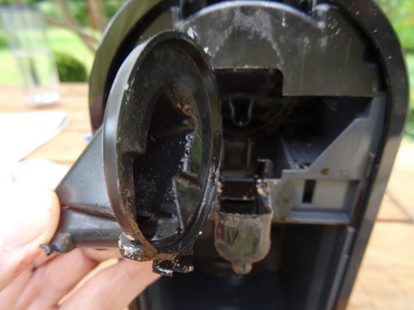

  6. Nespresso U inner coffee spout replacement: crwdns2935265:06crwdnd2935265:01crwdnd2935265:02crwdne2935265:0 Nespresso U inner coffee spout replacement: crwdns2935265:06crwdnd2935265:02crwdnd2935265:02crwdne2935265:0
    • Take the opportunity to clean the spout rocker and all internal parts.

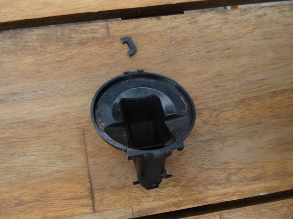

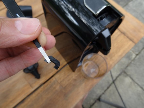

  8. Nespresso U inner coffee spout replacement: crwdns2935265:08crwdnd2935265:01crwdnd2935265:03crwdne2935265:0 Nespresso U inner coffee spout replacement: crwdns2935265:08crwdnd2935265:02crwdnd2935265:03crwdne2935265:0 Nespresso U inner coffee spout replacement: crwdns2935265:08crwdnd2935265:03crwdnd2935265:03crwdne2935265:0
    • The broken upper flap is still present here. Lift it out with tweezers.
