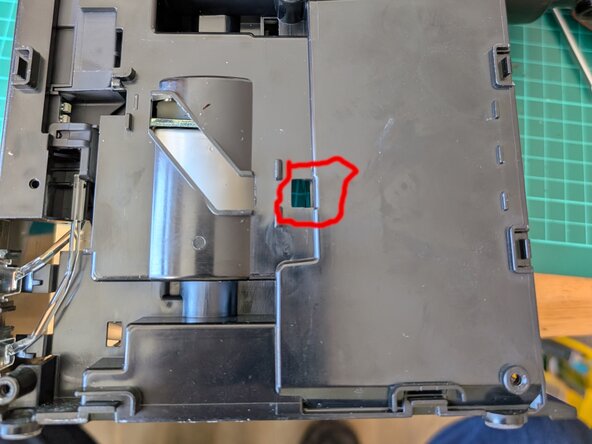

    • Seperate both halves of the machine using both a spudger and your hands.
    • Once you have unclipped the side at the top, middle of the side and base. You can push with a screw driver through the hole on the reverse side to help remove the plastic side.
    • Be sure to take your time and start in the middle. Note that it is incredibly well secured.

I’m sorry but this tutorial should be removed. You’ll just going to broke parts by following that.
