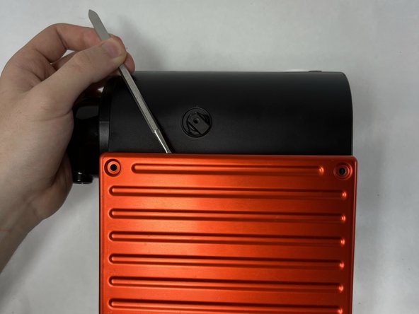

  4. Nespresso Pixie Brewing Spout Replacement: crwdns2935265:04crwdnd2935265:01crwdnd2935265:02crwdne2935265:0 Nespresso Pixie Brewing Spout Replacement: crwdns2935265:04crwdnd2935265:02crwdnd2935265:02crwdne2935265:0
    • Use a a Torx T5 screwdriver to unscrew the screws from each corner of both faceplates.
    • Remove the faceplate using a metal spudger.
    • Start in the corners and carefully separate them.

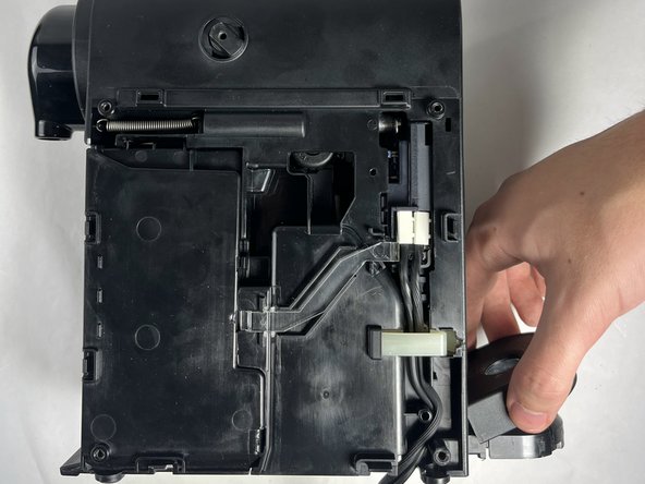

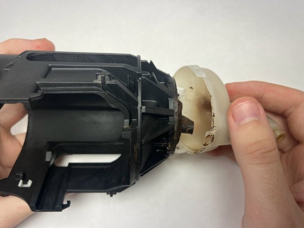

  5. Nespresso Pixie Brewing Spout Replacement: crwdns2935265:05crwdnd2935265:01crwdnd2935265:03crwdne2935265:0 Nespresso Pixie Brewing Spout Replacement: crwdns2935265:05crwdnd2935265:02crwdnd2935265:03crwdne2935265:0 Nespresso Pixie Brewing Spout Replacement: crwdns2935265:05crwdnd2935265:03crwdnd2935265:03crwdne2935265:0
    • Locate the two springs in each top right corner and remove them using precision tweezers.
    • Place your hand on the top to prevent the loss of springs and facilitate their retrieval.
    • Use your hand to remove the waterspout.
    • Remove white plastic bits using a screwdriver or metal spudger.

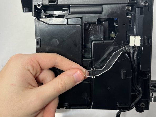

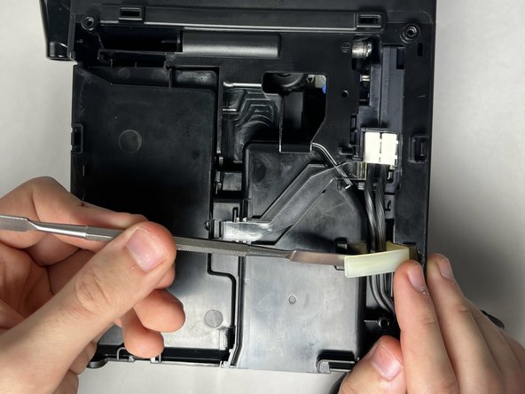

  6. Nespresso Pixie Brewing Spout Replacement: crwdns2935265:06crwdnd2935265:01crwdnd2935265:03crwdne2935265:0 Nespresso Pixie Brewing Spout Replacement: crwdns2935265:06crwdnd2935265:02crwdnd2935265:03crwdne2935265:0 Nespresso Pixie Brewing Spout Replacement: crwdns2935265:06crwdnd2935265:03crwdnd2935265:03crwdne2935265:0
    • Remove the clear plastic bits with a metal spudger.
    • Gently disconnect the power cables from the machine with your hands.

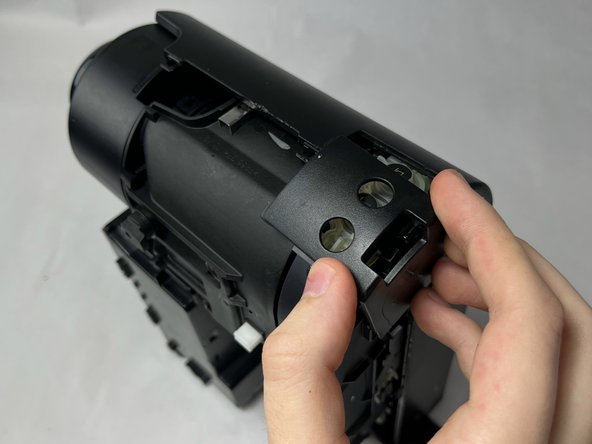

  7. Nespresso Pixie Brewing Spout Replacement: crwdns2935265:07crwdnd2935265:01crwdnd2935265:02crwdne2935265:0 Nespresso Pixie Brewing Spout Replacement: crwdns2935265:07crwdnd2935265:02crwdnd2935265:02crwdne2935265:0
    • Use a metal spudger tool and your hands to remove the outer shell.
    • Take your time during this step and initiate the process from the center, where the marker is located.
    • Note these pieces are securely fastened to the machine.
    • Using your hands, gently separate the plastic that is covering the coffee size buttons.

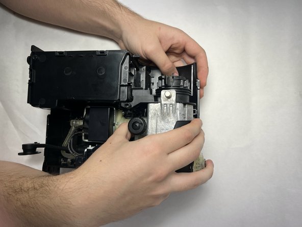

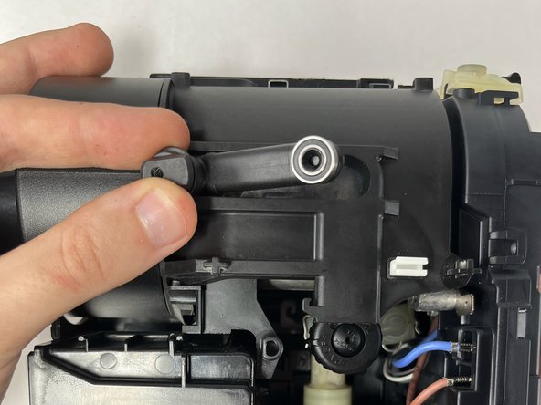

  8. Nespresso Pixie Brewing Spout Replacement: crwdns2935265:08crwdnd2935265:01crwdnd2935265:03crwdne2935265:0 Nespresso Pixie Brewing Spout Replacement: crwdns2935265:08crwdnd2935265:02crwdnd2935265:03crwdne2935265:0 Nespresso Pixie Brewing Spout Replacement: crwdns2935265:08crwdnd2935265:03crwdnd2935265:03crwdne2935265:0
    • Apply steady pressure to both ends of the brewing chamber, pushing it in to extract the lever housing.
    • Remove the lever housing by gripping it with your hands and pulling it out.
    • After separating it, remove the other handle holder using the same method as outlined in the previous step.

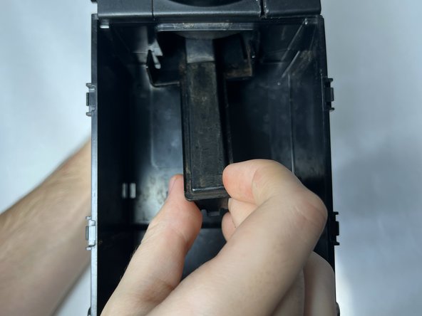

  9. Nespresso Pixie Brewing Spout Replacement: crwdns2935265:09crwdnd2935265:01crwdnd2935265:03crwdne2935265:0 Nespresso Pixie Brewing Spout Replacement: crwdns2935265:09crwdnd2935265:02crwdnd2935265:03crwdne2935265:0 Nespresso Pixie Brewing Spout Replacement: crwdns2935265:09crwdnd2935265:03crwdnd2935265:03crwdne2935265:0

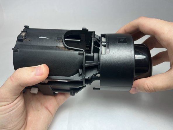

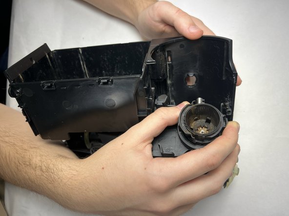

    • Pull the brewing chamber cover outwards from the machine, then pull it downwards to detach.
    • Use your hands to pull the brewing mechanism apart from the remaining plastic barrier.
  10. Nespresso Pixie Brewing Spout Replacement: crwdns2935265:010crwdnd2935265:01crwdnd2935265:03crwdne2935265:0 Nespresso Pixie Brewing Spout Replacement: crwdns2935265:010crwdnd2935265:02crwdnd2935265:03crwdne2935265:0 Nespresso Pixie Brewing Spout Replacement: crwdns2935265:010crwdnd2935265:03crwdnd2935265:03crwdne2935265:0
    • Utilize a metal spudger to disengage the clips securing the black case in position.
    • Draw the brewing chamber outward from the machine, and then pull it downward to disconnect the brewing spout chamber.
    • Following the disconnection of the brewing spout chamber, the inner brewing spout will become visible.

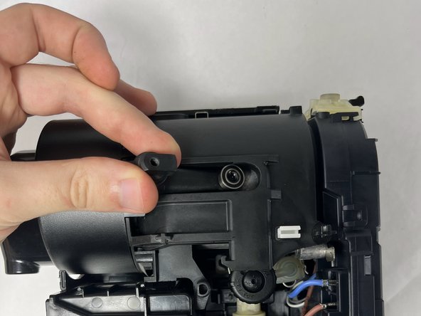

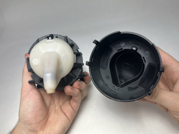

  11. Nespresso Pixie Brewing Spout Replacement: crwdns2935265:011crwdnd2935265:01crwdnd2935265:03crwdne2935265:0 Nespresso Pixie Brewing Spout Replacement: crwdns2935265:011crwdnd2935265:02crwdnd2935265:03crwdne2935265:0 Nespresso Pixie Brewing Spout Replacement: crwdns2935265:011crwdnd2935265:03crwdnd2935265:03crwdne2935265:0
    • Utilize a metal spudger to disengage the clips securing the white inner brewing spout in position.
  12. Nespresso Pixie Brewing Spout Replacement: crwdns2935265:012crwdnd2935265:01crwdnd2935265:02crwdne2935265:0 Nespresso Pixie Brewing Spout Replacement: crwdns2935265:012crwdnd2935265:02crwdnd2935265:02crwdne2935265:0
    • Examine the coffee spout and the areas through which coffee passes to remove any trapped coffee grounds, scale, or debris, ensuring a clear pathway.
    • Clean the brewing spout thoroughly with a damp cloth, water, and mild soap to remove any remaining debris.
