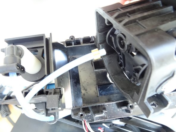

    • Use a metal spudger and insert it into the seam between the inner coffee spout and the brewing unit. Pry off the coffee spout.
    • Remove the inner coffee spout.
  15. Nespresso CitiZ Brewing Unit replace: crwdns2935265:015crwdnd2935265:01crwdnd2935265:03crwdne2935265:0 Nespresso CitiZ Brewing Unit replace: crwdns2935265:015crwdnd2935265:02crwdnd2935265:03crwdne2935265:0 Nespresso CitiZ Brewing Unit replace: crwdns2935265:015crwdnd2935265:03crwdnd2935265:03crwdne2935265:0

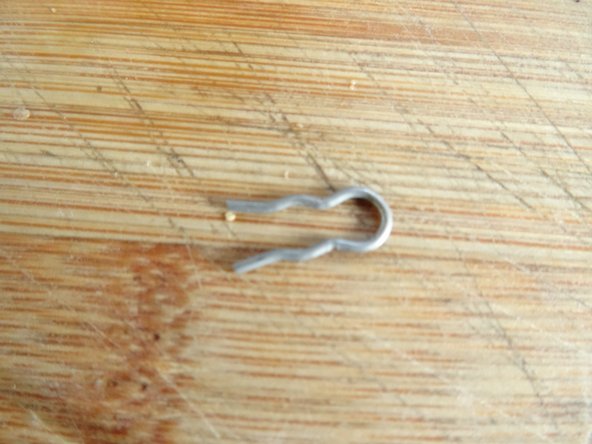

    • The brewing unit now remains only attached to the hot water hose. Use the metal spudger to pull out the metal clip at the end of the hose.
    • Pull out the end of the hot water hose.
  16. Nespresso CitiZ Brewing Unit replace: crwdns2935265:016crwdnd2935265:01crwdnd2935265:01crwdne2935265:0
    • Lift the brewing unit from the device.
