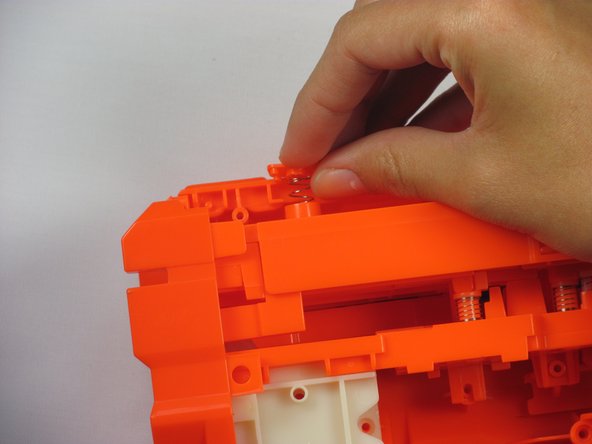

    • The two slide pieces hold the orange sight in place. Expect that the sight will come off when you remove the slide pieces.
    • Using a screwdriver, carefully unscrew the three #00 1 cm Phillips screws holding the two slide pieces together.
    • Both sides of the slide will come off when the screws are removed.
  2. Nerf Vortex Vigilon Clip Attachment Replacement, Removing the slide pieces: crwdns2935265:02crwdnd2935265:01crwdnd2935265:01crwdne2935265:0
    • Lift both slide pieces off of the gun.
  3. Nerf Vortex Vigilon Clip Attachment Replacement, Removing the outer screws: crwdns2935265:03crwdnd2935265:01crwdnd2935265:02crwdne2935265:0 Nerf Vortex Vigilon Clip Attachment Replacement, Removing the outer screws: crwdns2935265:03crwdnd2935265:02crwdnd2935265:02crwdne2935265:0
    • Remove the twelve #00 1 cm Phillips screws.
    • Because the holes for the screws are deeper than the screw size, some of the screws may not come out even after you have completely unscrewed them. They will come out when you take off the outside cover in the next step, which is okay.
    • Rotate the gun so that the front is facing you to remove the final screw.
  4. Nerf Vortex Vigilon Clip Attachment Replacement, Removing the outside cover: crwdns2935265:04crwdnd2935265:01crwdnd2935265:01crwdne2935265:0
    • When removing the cover, the clip attachment and the spring will likely fall out of the gun.
    • Lift the outside cover off of the gun. Only the side where you removed the screws will come off.
    • The magazine will slide down automatically as you remove the cover.
  5. Nerf Vortex Vigilon Clip Attachment Replacement, Removing the clip attachment: crwdns2935265:05crwdnd2935265:01crwdnd2935265:02crwdne2935265:0 Nerf Vortex Vigilon Clip Attachment Replacement, Removing the clip attachment: crwdns2935265:05crwdnd2935265:02crwdnd2935265:02crwdne2935265:0
    • At the top left area of the gun, lift the clip towards you, and it will easily slide out.
