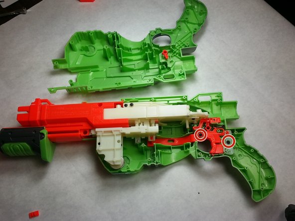

    • Start by taking out all of the screws for the casing of the gun. Using the PH #00 screwdriver, unscrew all four 1.3-cm screws in the pump.
  2. Nerf Vortex Praxis Trigger Replacement: crwdns2935265:02crwdnd2935265:01crwdnd2935265:01crwdne2935265:0
    • Take out all of the screws with a Phillips screwdriver. Using a PH #00 Screwdriver, unscrew all fourteen, 1.2 cm screws.
  3. Nerf Vortex Praxis Trigger Replacement: crwdns2935265:03crwdnd2935265:01crwdnd2935265:01crwdne2935265:0
    • Remove the small stock at the back end of the gun by removing two, 1 cm screws.
  4. Nerf Vortex Praxis Trigger Replacement: crwdns2935265:04crwdnd2935265:01crwdnd2935265:01crwdne2935265:0
    • Pull apart the case of the gun by pulling up.
  5. Nerf Vortex Praxis Trigger Replacement: crwdns2935265:05crwdnd2935265:01crwdnd2935265:02crwdne2935265:0 Nerf Vortex Praxis Trigger Replacement: crwdns2935265:05crwdnd2935265:02crwdnd2935265:02crwdne2935265:0
    • Remove the trigger components by removing these two, 1.2 cm screws.
  6. Nerf Vortex Praxis Trigger Replacement: crwdns2935265:06crwdnd2935265:01crwdnd2935265:01crwdne2935265:0
    • Pick up the pieces to the trigger assembly for replacement.
