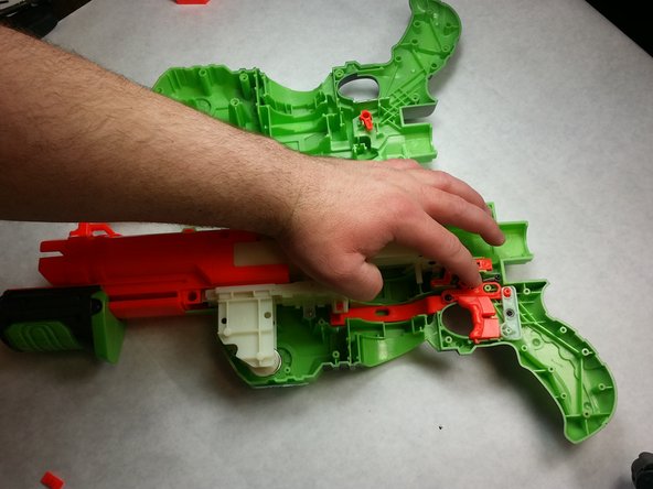

    • Start by taking out all of the screws for the casing of the gun. Using the PH #00 screwdriver, unscrew all four 1.3 cm screws in the pump.
  2. Nerf Vortex Praxis Handle Replacement: crwdns2935265:02crwdnd2935265:01crwdnd2935265:01crwdne2935265:0
    • Take out all of the screws with a Phillips screwdriver. Using a PH #00 Screwdriver, unscrew all fourteen, 1.2 cm screws.
  3. Nerf Vortex Praxis Handle Replacement: crwdns2935265:03crwdnd2935265:01crwdnd2935265:01crwdne2935265:0
    • Remove the small stock at the back end of the gun by removing two, 1-cm screws.
  4. Nerf Vortex Praxis Handle Replacement: crwdns2935265:04crwdnd2935265:01crwdnd2935265:01crwdne2935265:0
    • Pull apart the case of the gun.
  5. Nerf Vortex Praxis Handle Replacement: crwdns2935265:05crwdnd2935265:01crwdnd2935265:01crwdne2935265:0
    • Remove the 1.2 cm Phillips screw towards the front of the blaster.
    • Remove the silver 1.1 cm Phillips screw next to the first screw.
  6. Nerf Vortex Praxis Handle Replacement: crwdns2935265:06crwdnd2935265:01crwdnd2935265:02crwdne2935265:0 Nerf Vortex Praxis Handle Replacement: crwdns2935265:06crwdnd2935265:02crwdnd2935265:02crwdne2935265:0
    • Remove the trigger components by removing these two 1.2 cm screws.
  7. Nerf Vortex Praxis Handle Replacement: crwdns2935265:07crwdnd2935265:01crwdnd2935265:01crwdne2935265:0
    • Remove the .7-cm screws towards the back of the inside of the outer case.
  8. Nerf Vortex Praxis Handle Replacement: crwdns2935265:08crwdnd2935265:01crwdnd2935265:01crwdne2935265:0
    • Remove single 1.2 cm screw that connects loading assembly.
  9. Nerf Vortex Praxis Handle Replacement: crwdns2935265:09crwdnd2935265:01crwdnd2935265:01crwdne2935265:0
    • Pull out the white piece from the rest of the gun.
  10. Nerf Vortex Praxis Handle Replacement: crwdns2935265:010crwdnd2935265:01crwdnd2935265:01crwdne2935265:0
    • Pull off the orange piece.
    • The outer casing can now be replaced.
