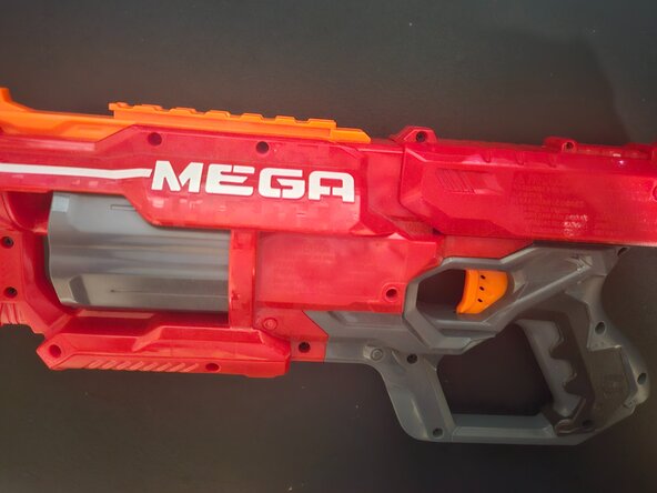

    • Remove all 12 screws with Phillips #1 screwdriver. Keep them in a small container to prevent loss.
    • It is recommended to use a Phillips #0 screwdriver to remove this screw. A Phillips #1 screwdriver can be used, but it may damage the screw, and a new screw will be required.
    • Carefully pry the primer off.
    • The nerf Cycloneshock uses 8 10mm, 3 12mm, and 1 8mm screw

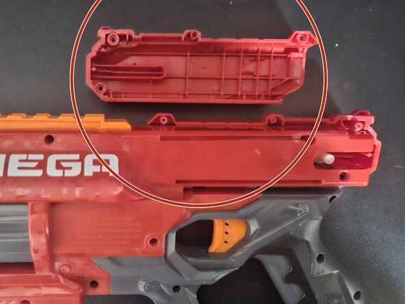

  2. Nerf N-Strike Mega Cycloneshock Plunger Spring Replacement: crwdns2935265:02crwdnd2935265:01crwdnd2935265:01crwdne2935265:0
    • Gently pry open the shell. If it does not come off easily, double check that all screws are fully removed.

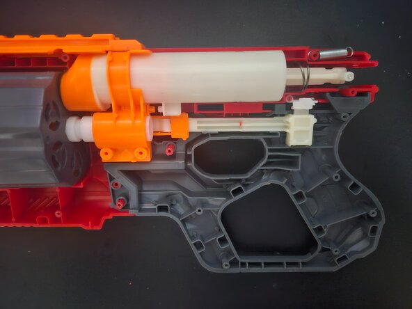

  3. Nerf N-Strike Mega Cycloneshock Plunger Spring Replacement: crwdns2935265:03crwdnd2935265:01crwdnd2935265:03crwdne2935265:0 Nerf N-Strike Mega Cycloneshock Plunger Spring Replacement: crwdns2935265:03crwdnd2935265:02crwdnd2935265:03crwdne2935265:0 Nerf N-Strike Mega Cycloneshock Plunger Spring Replacement: crwdns2935265:03crwdnd2935265:03crwdnd2935265:03crwdne2935265:0

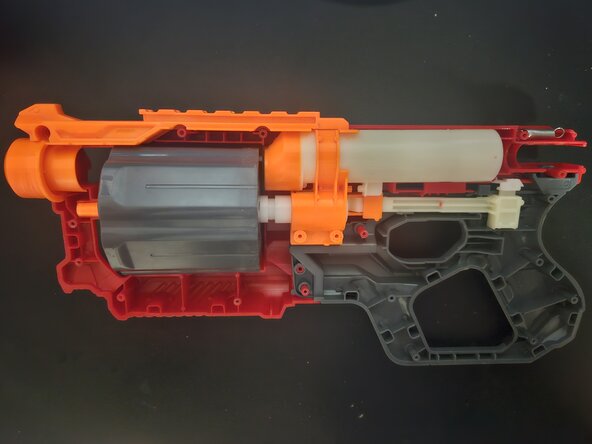

    • Locate the trigger and hook, then carefully remove them.
    • For this step you don't need screwdriver.
  4. Nerf N-Strike Mega Cycloneshock Plunger Spring Replacement: crwdns2935265:04crwdnd2935265:01crwdnd2935265:02crwdne2935265:0 Nerf N-Strike Mega Cycloneshock Plunger Spring Replacement: crwdns2935265:04crwdnd2935265:02crwdnd2935265:02crwdne2935265:0

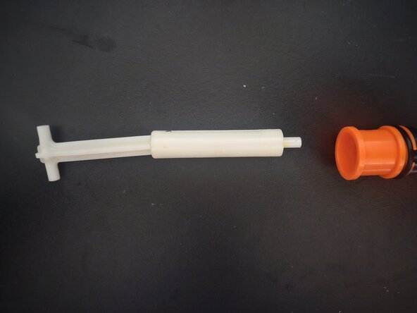

    • Gently lift the plunger mechanism towards yourself, then carefully remove the plunger.

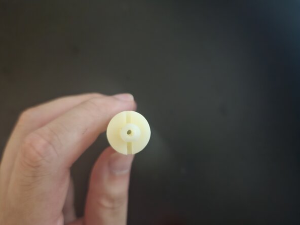

  5. Nerf N-Strike Mega Cycloneshock Plunger Spring Replacement: crwdns2935265:05crwdnd2935265:01crwdnd2935265:03crwdne2935265:0 Nerf N-Strike Mega Cycloneshock Plunger Spring Replacement: crwdns2935265:05crwdnd2935265:02crwdnd2935265:03crwdne2935265:0 Nerf N-Strike Mega Cycloneshock Plunger Spring Replacement: crwdns2935265:05crwdnd2935265:03crwdnd2935265:03crwdne2935265:0

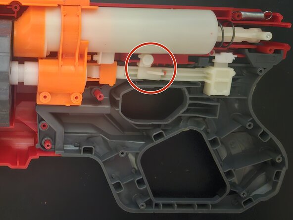

    • Find the screw on the plunger.
    • Use a Phillips #1 Screwdriver to unscrew it.
    • Slide the old plunger spring off the plunger rod. If the spring is stuck, gently wiggle it free, and make sure you do not damage surrounding components.

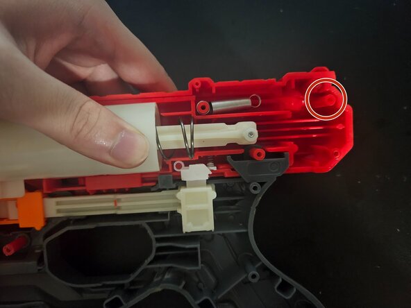

  6. Nerf N-Strike Mega Cycloneshock Plunger Spring Replacement: crwdns2935265:06crwdnd2935265:01crwdnd2935265:03crwdne2935265:0 Nerf N-Strike Mega Cycloneshock Plunger Spring Replacement: crwdns2935265:06crwdnd2935265:02crwdnd2935265:03crwdne2935265:0 Nerf N-Strike Mega Cycloneshock Plunger Spring Replacement: crwdns2935265:06crwdnd2935265:03crwdnd2935265:03crwdne2935265:0

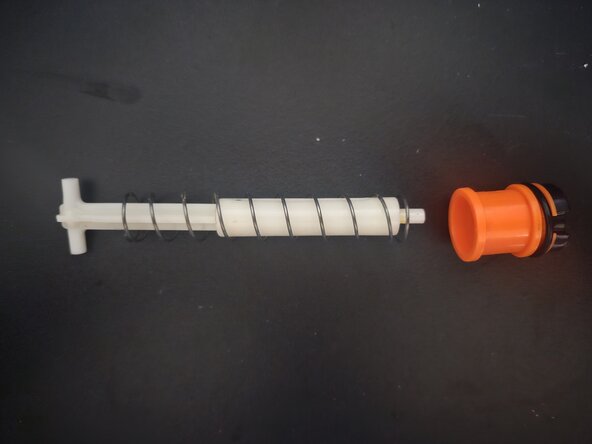

    • Slide the new spring onto the plunger rod.
    • Put top back on aligning groves with plunger.
    • Compress the spring makes it easier.

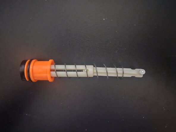

  7. Nerf N-Strike Mega Cycloneshock Plunger Spring Replacement: crwdns2935265:07crwdnd2935265:01crwdnd2935265:03crwdne2935265:0 Nerf N-Strike Mega Cycloneshock Plunger Spring Replacement: crwdns2935265:07crwdnd2935265:02crwdnd2935265:03crwdne2935265:0 Nerf N-Strike Mega Cycloneshock Plunger Spring Replacement: crwdns2935265:07crwdnd2935265:03crwdnd2935265:03crwdne2935265:0
    • Place the plunger assembly back in its correct position.
    • Place back of plunger in grove.
    • Align all internal components properly before closing the shell.
    • Use a Phillips screwdriver to reinstall all screws.
    • Load a Nerf and test fire to check functionality.
By following this guide, you have successfully replaced the plunger spring in your Nerf N-Strike Mega Cycloneshock. This simple upgrade can restore and ensure stronger and more consistent shots, and if you experience any issues, double check the alignment of internal components.
