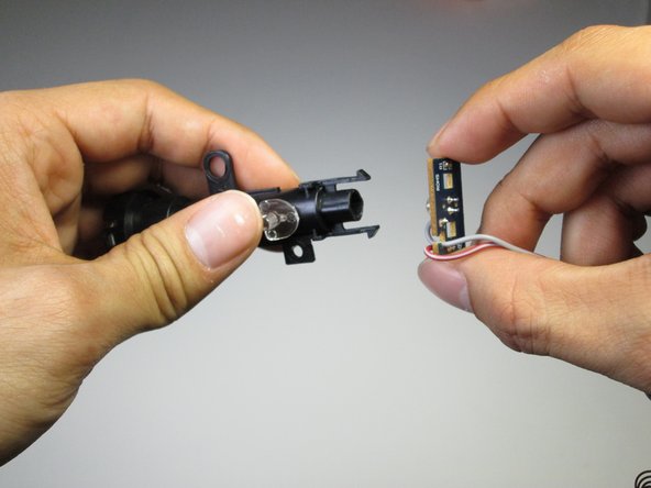

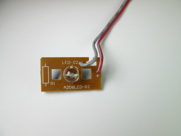

    1. Nerf N-Strike Firestrike Wire Replacement, Wire: crwdns2935265:010crwdnd2935265:01crwdnd2935265:02crwdne2935265:0 Nerf N-Strike Firestrike Wire Replacement, Wire: crwdns2935265:010crwdnd2935265:02crwdnd2935265:02crwdne2935265:0
      • Pinch the clips holding the circuit board to the laser assembly and remove the circuit board.
    2. Nerf N-Strike Firestrike Wire Replacement: crwdns2935265:011crwdnd2935265:01crwdnd2935265:01crwdne2935265:0
      • Desolder the wires from the circuit board.
      • The positive wire is attached at the lower left, while the negative wire is attached at the middle of the bottom.
    3. Nerf N-Strike Firestrike Wire Replacement: crwdns2935265:012crwdnd2935265:01crwdnd2935265:02crwdne2935265:0 Nerf N-Strike Firestrike Wire Replacement: crwdns2935265:012crwdnd2935265:02crwdnd2935265:02crwdne2935265:0
      • Use a soldering iron to melt the solder attaching the wires to the circuit board.
      • The positive lead is attached at the middle right of the board, while the negative lead is attached at the bottom right of the board.
