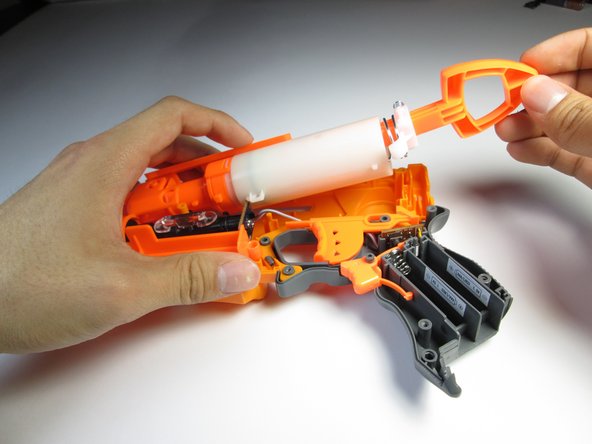

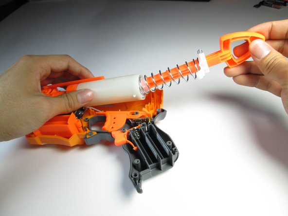

  6. Nerf N-Strike Firestrike O-Ring and Plunger Replacement, O-Ring and Plunger: crwdns2935265:06crwdnd2935265:01crwdnd2935265:03crwdne2935265:0 Nerf N-Strike Firestrike O-Ring and Plunger Replacement, O-Ring and Plunger: crwdns2935265:06crwdnd2935265:02crwdnd2935265:03crwdne2935265:0 Nerf N-Strike Firestrike O-Ring and Plunger Replacement, O-Ring and Plunger: crwdns2935265:06crwdnd2935265:03crwdnd2935265:03crwdne2935265:0
    • Without removing the barrel assembly, tilt it slightly upwards.
    • Slide the plunger out from the air chamber.
