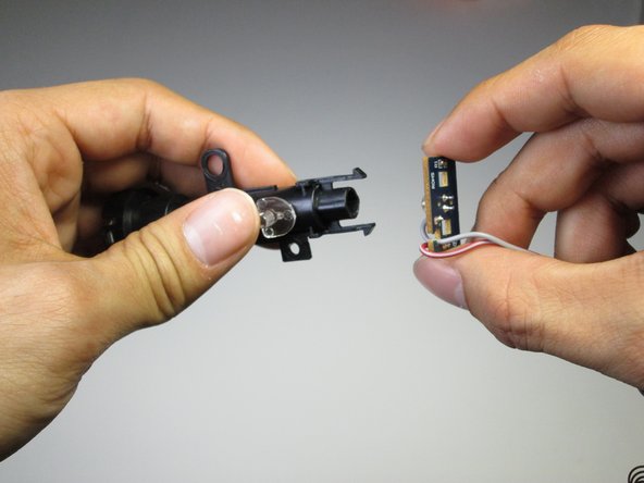

    1. Nerf N-Strike Firestrike LED Replacement, LED: crwdns2935265:09crwdnd2935265:01crwdnd2935265:02crwdne2935265:0 Nerf N-Strike Firestrike LED Replacement, LED: crwdns2935265:09crwdnd2935265:02crwdnd2935265:02crwdne2935265:0
      • Pinch the clips holding the laser beam casing to the circuit board with your fingers. Slide off the casing revealing the LED.
    2. Nerf N-Strike Firestrike LED Replacement: crwdns2935265:010crwdnd2935265:01crwdnd2935265:01crwdne2935265:0
      • Use a soldering iron to heat up the two connections holding the LED to the circuit board. Remove the LED.
