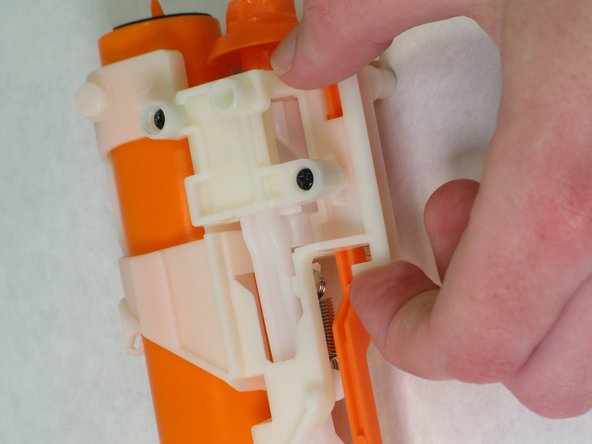

  5. Nerf N-Strike Elite Strongarm Main Spring Replacement: crwdns2935265:05crwdnd2935265:01crwdnd2935265:01crwdne2935265:0
    • Remove the air plunger and the spring from inside the chamber.

  8. Nerf N-Strike Elite Strongarm Main Spring Replacement: crwdns2935265:08crwdnd2935265:01crwdnd2935265:01crwdne2935265:0
    • Return the plunger to the spring chamber.

  10. Nerf N-Strike Elite Strongarm Main Spring Replacement: crwdns2935265:010crwdnd2935265:01crwdnd2935265:01crwdne2935265:0
    • Place the spring chamber and the Nerf bullet cylinder back into the base.
  11. Nerf N-Strike Elite Strongarm Main Spring Replacement: crwdns2935265:011crwdnd2935265:01crwdnd2935265:02crwdne2935265:0 Nerf N-Strike Elite Strongarm Main Spring Replacement: crwdns2935265:011crwdnd2935265:02crwdnd2935265:02crwdne2935265:0
    • Screw the trigger and the action back in. Swing the gray gun charging slide out when putting the action back in.
