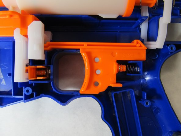

  5. Nerf N-Strike Elite Retaliator Trigger Spring Replacement: crwdns2935265:05crwdnd2935265:01crwdnd2935265:02crwdne2935265:0 Nerf N-Strike Elite Retaliator Trigger Spring Replacement: crwdns2935265:05crwdnd2935265:02crwdnd2935265:02crwdne2935265:0
    • Remove the eleven 8mm and two 10mm Phillips head screws from the left side of the blaster, and carefully remove the outer casing.
    • Two of the screws must be removed with the sliding mechanism in the forward position. Another two must be removed with the sliding mechanism in the back position.
    • There are several springs that may become displaced during this procedure. Proceed with the utmost caution.

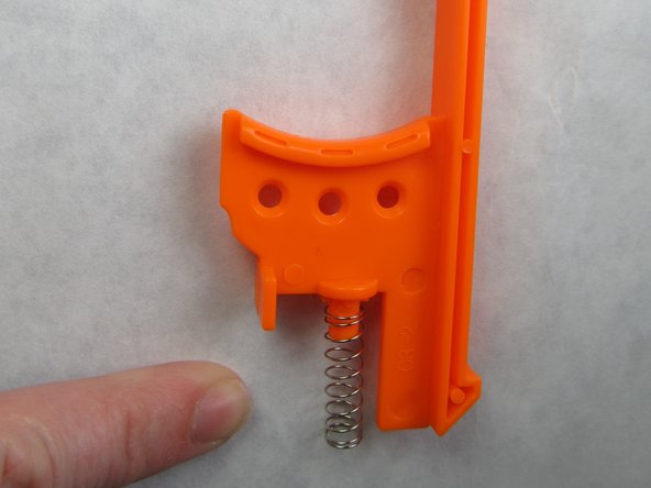

  6. Nerf N-Strike Elite Retaliator Trigger Spring Replacement, Trigger Spring: crwdns2935265:06crwdnd2935265:01crwdnd2935265:03crwdne2935265:0 Nerf N-Strike Elite Retaliator Trigger Spring Replacement, Trigger Spring: crwdns2935265:06crwdnd2935265:02crwdnd2935265:03crwdne2935265:0 Nerf N-Strike Elite Retaliator Trigger Spring Replacement, Trigger Spring: crwdns2935265:06crwdnd2935265:03crwdnd2935265:03crwdne2935265:0
    • Carefully pull the orange trigger upward and backward to remove it from the blaster.
    • This component is under spring pressure. Wear appropriate personal protective equipment to shield your eyes.
    • Remove the spring from the rear of the trigger.
