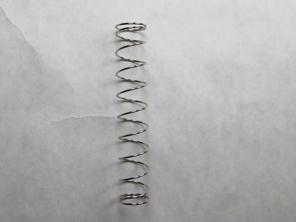

  6. Nerf N-Strike Elite Retaliator Spring Replacement, Remove Old Firing Spring: crwdns2935265:06crwdnd2935265:01crwdnd2935265:02crwdne2935265:0 Nerf N-Strike Elite Retaliator Spring Replacement, Remove Old Firing Spring: crwdns2935265:06crwdnd2935265:02crwdnd2935265:02crwdne2935265:0
    • The spring may be compressed. If so, carefully release spring pressure before proceeding.
    • While holding down the white Plunger tube, pull the spring backwards to remove it from the blaster.
