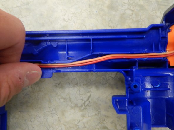

    • To remove the motor and trigger mechanism you have to detach these two wires which are glued to the shell.
    • Hold close to the wire and pull upward slowly.
    • If you pull too quickly you can potentially damage the wire.

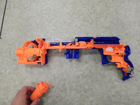

    • Once all the pieces are removed the right shell should be fully accessible.
