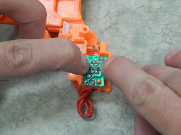

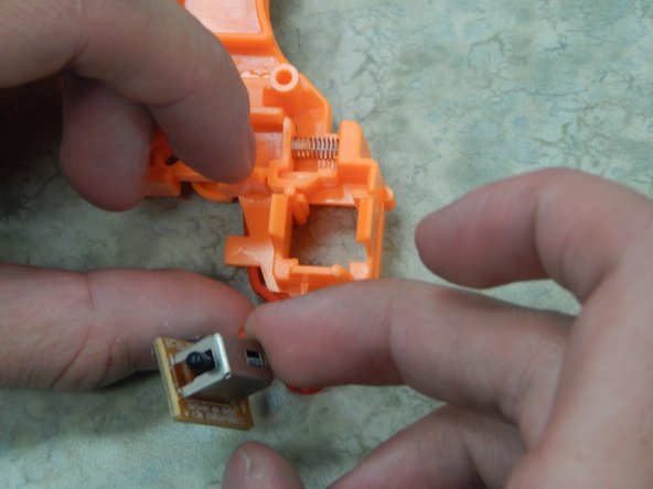

  21. Nerf N-Strike Elite Hail-Fire Trigger Circuit Board Replacement, Trigger Circuit Board: crwdns2935265:021crwdnd2935265:01crwdnd2935265:01crwdne2935265:0
    • Once you have the handle disassembled locate the triggering circuit board.

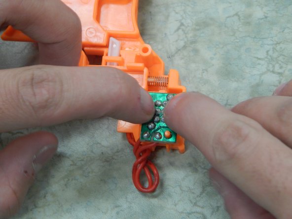

  22. Nerf N-Strike Elite Hail-Fire Trigger Circuit Board Replacement: crwdns2935265:022crwdnd2935265:01crwdnd2935265:03crwdne2935265:0 Nerf N-Strike Elite Hail-Fire Trigger Circuit Board Replacement: crwdns2935265:022crwdnd2935265:02crwdnd2935265:03crwdne2935265:0 Nerf N-Strike Elite Hail-Fire Trigger Circuit Board Replacement: crwdns2935265:022crwdnd2935265:03crwdnd2935265:03crwdne2935265:0
    • Find the two plastic clasps and position your hands so you can pry them open with your fingers. We recommend that you try and pry them open without removing the piece so you can feel how fragile the plastic is.
  23. Nerf N-Strike Elite Hail-Fire Trigger Circuit Board Replacement: crwdns2935265:023crwdnd2935265:01crwdnd2935265:02crwdne2935265:0 Nerf N-Strike Elite Hail-Fire Trigger Circuit Board Replacement: crwdns2935265:023crwdnd2935265:02crwdnd2935265:02crwdne2935265:0
    • The circuit board has sharp metal solder points on it. If your finger slips you could injure yourself. Consider using gloves.
    • To remove use two fingers to pry the plastic edges apart and with your thumbs remove the circuit board. Having a friend help with this step could be beneficial.
