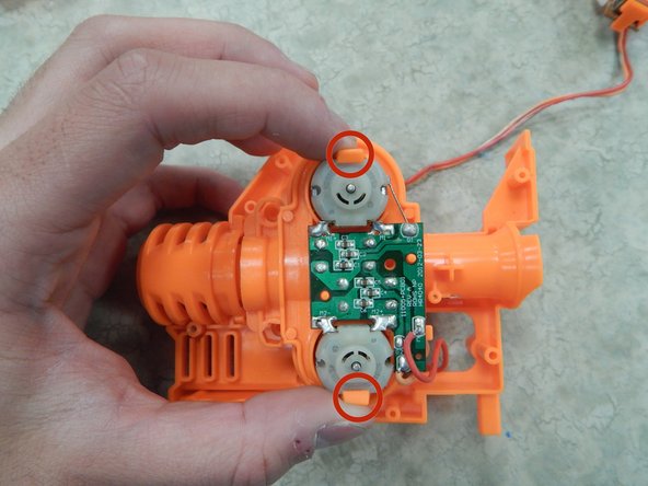

  19. Nerf N-Strike Elite Hail-Fire Motor Replacement: crwdns2935265:019crwdnd2935265:01crwdnd2935265:03crwdne2935265:0 Nerf N-Strike Elite Hail-Fire Motor Replacement: crwdns2935265:019crwdnd2935265:02crwdnd2935265:03crwdne2935265:0 Nerf N-Strike Elite Hail-Fire Motor Replacement: crwdns2935265:019crwdnd2935265:03crwdnd2935265:03crwdne2935265:0

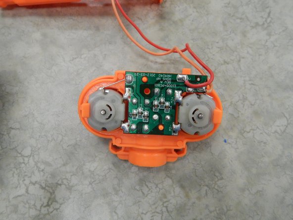

    • With the shell now removed, locate the motor and controlling circuit board. With your index finger and thumb, squeeze the holders shown in Figure 2 and pull upwards to release the motor module from the rest of the motor's casing. Your motor should be detached from the casing, as shown in Figure 3.
  20. Nerf N-Strike Elite Hail-Fire Motor Replacement: crwdns2935265:020crwdnd2935265:01crwdnd2935265:01crwdne2935265:0
    • Remove the wiring from the motor by disconnecting the wires from the circuit board.
