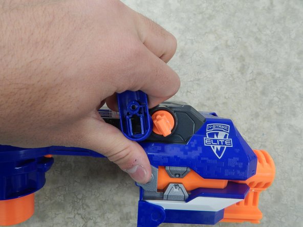

  5. Nerf N-Strike Elite Hail-Fire Left Shell Replacement: crwdns2935265:05crwdnd2935265:01crwdnd2935265:01crwdne2935265:0
    • Remove the four 9.0 mm Phillips screws from the newly revealed cylinder.
  6. Nerf N-Strike Elite Hail-Fire Left Shell Replacement: crwdns2935265:06crwdnd2935265:01crwdnd2935265:01crwdne2935265:0
    • Remove the three 9.0 mm Phillips screws holding the top latch of the Nerf Gun together.

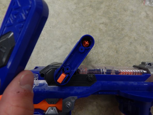

  7. Nerf N-Strike Elite Hail-Fire Left Shell Replacement: crwdns2935265:07crwdnd2935265:01crwdnd2935265:01crwdne2935265:0
    • Remove the three 9.0 mm Phillips screws holding together the firing chamber.
    • Remove the single 7.0 mm Phillips screw below the barrel.

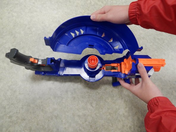

  12. Nerf N-Strike Elite Hail-Fire Left Shell Replacement: crwdns2935265:012crwdnd2935265:01crwdnd2935265:03crwdne2935265:0 Nerf N-Strike Elite Hail-Fire Left Shell Replacement: crwdns2935265:012crwdnd2935265:02crwdnd2935265:03crwdne2935265:0 Nerf N-Strike Elite Hail-Fire Left Shell Replacement: crwdns2935265:012crwdnd2935265:03crwdnd2935265:03crwdne2935265:0
    • Lift the entire left shell slowly. The process should be easy and if there is any resistance, there is something wrong. You may have forgotten a screw.
    • Completely remove the left shell from the rest of the Nerf Gun.
