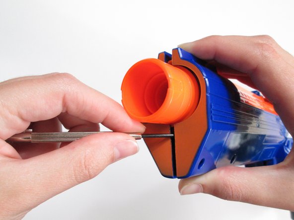

    • Looking at the rear of the rifle, remove the two 10 mm phillips screws holding the orange cap to the butt of the rifle.
    • Pull off the orange cap.

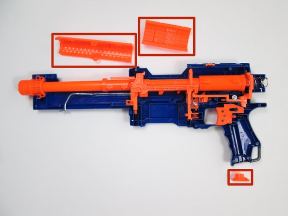

    • Pull the two halves of the rifle apart.
    • Be careful of the spring at the rear end of the rifle. It may come flying out.
    • If you have difficulty pulling the two halves apart, use a spudger gently pry the edges of the body apart.
    • Also be careful of small parts when opening the gun, they may be easy to lose.
    • Remove the access gate and barrel cover.

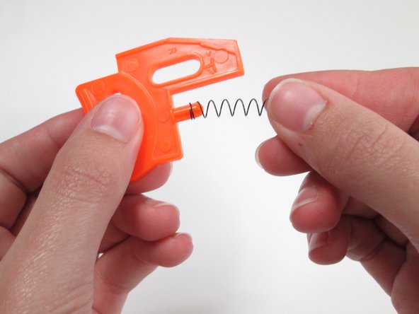

  6. Nerf N-Strike Elite Alpha Trooper CS-12 Trigger Spring Replacement, Trigger Removal: crwdns2935265:06crwdnd2935265:01crwdnd2935265:03crwdne2935265:0 Nerf N-Strike Elite Alpha Trooper CS-12 Trigger Spring Replacement, Trigger Removal: crwdns2935265:06crwdnd2935265:02crwdnd2935265:03crwdne2935265:0 Nerf N-Strike Elite Alpha Trooper CS-12 Trigger Spring Replacement, Trigger Removal: crwdns2935265:06crwdnd2935265:03crwdnd2935265:03crwdne2935265:0
    • Remove the single 8mm phillips screw holding the trigger mechanism is place.
    • Remove the trigger mechanism.
    • Remove the small spring from the rear of the mechanism and replace it with a new spring.
