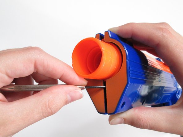

  7. Nerf N-Strike Elite Alpha Trooper CS-12 Hammer Rod Replacement, Hammer Rod: crwdns2935265:07crwdnd2935265:01crwdnd2935265:02crwdne2935265:0 Nerf N-Strike Elite Alpha Trooper CS-12 Hammer Rod Replacement, Hammer Rod: crwdns2935265:07crwdnd2935265:02crwdnd2935265:02crwdne2935265:0
    • Remove the two 5 mm phillips screws holding the muzzle in place.

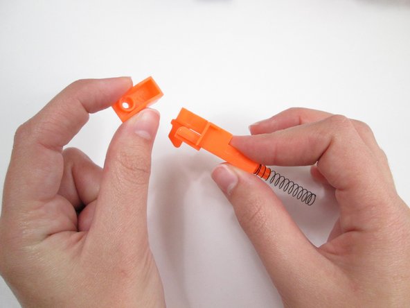

  12. Nerf N-Strike Elite Alpha Trooper CS-12 Hammer Rod Replacement: crwdns2935265:012crwdnd2935265:01crwdnd2935265:01crwdne2935265:0
    • With the plunger in the air cylinder, pull the plunger lock out of the rifle body.
  13. Nerf N-Strike Elite Alpha Trooper CS-12 Hammer Rod Replacement: crwdns2935265:013crwdnd2935265:01crwdnd2935265:01crwdne2935265:0
    • Pull the air cylinder and plunger assembly rearwards and out of the rifle.
  14. Nerf N-Strike Elite Alpha Trooper CS-12 Hammer Rod Replacement: crwdns2935265:014crwdnd2935265:01crwdnd2935265:01crwdne2935265:0
    • While holding the slide lock mechanism down, pull the bullet chamber assembly up and out of the rifle.
    • Part of the magazine lock mechanism should come along with it.

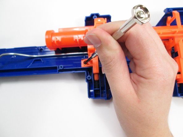

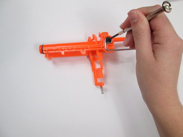

  15. Nerf N-Strike Elite Alpha Trooper CS-12 Hammer Rod Replacement: crwdns2935265:015crwdnd2935265:01crwdnd2935265:02crwdne2935265:0 Nerf N-Strike Elite Alpha Trooper CS-12 Hammer Rod Replacement: crwdns2935265:015crwdnd2935265:02crwdnd2935265:02crwdne2935265:0
    • With the hammer rod side of the bullet chamber facing you, unscrew the 5 mm phillips screw holding the hammer rod in place.
  16. Nerf N-Strike Elite Alpha Trooper CS-12 Hammer Rod Replacement: crwdns2935265:016crwdnd2935265:01crwdnd2935265:01crwdne2935265:0
    • Remove the hammer rod.
