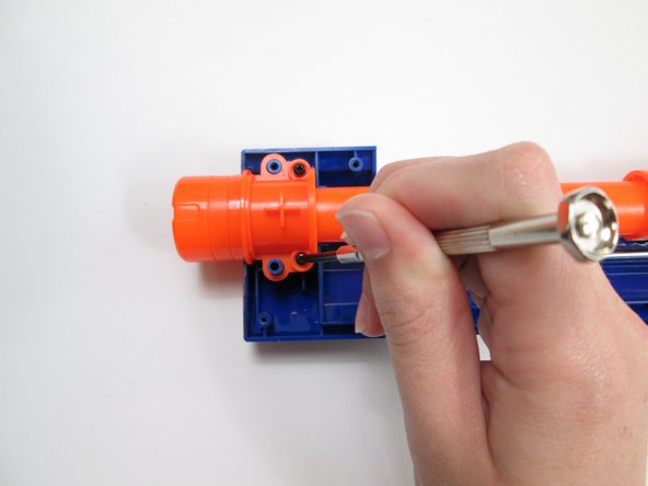

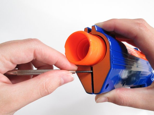

  5. Nerf N-Strike Elite Alpha Trooper CS-12 Barrel Replacement: crwdns2935265:05crwdnd2935265:01crwdnd2935265:02crwdne2935265:0 Nerf N-Strike Elite Alpha Trooper CS-12 Barrel Replacement: crwdns2935265:05crwdnd2935265:02crwdnd2935265:02crwdne2935265:0
    • Remove the two 5mm phillips screws from the rifle muzzle.
  6. Nerf N-Strike Elite Alpha Trooper CS-12 Barrel Replacement: crwdns2935265:06crwdnd2935265:01crwdnd2935265:01crwdne2935265:0
    • Remove the muzzle and barrel from the rifle body.
  7. Nerf N-Strike Elite Alpha Trooper CS-12 Barrel Replacement: crwdns2935265:07crwdnd2935265:01crwdnd2935265:01crwdne2935265:0
    • Separate the muzzle from the barrel.
