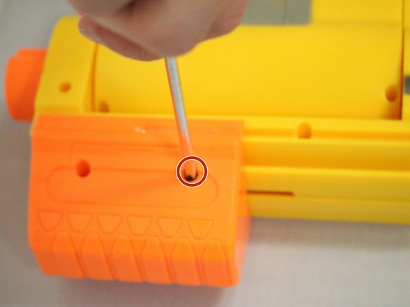

    • Proceed to take out hidden screws as shown.
    • Device must be collapsed in order to take out the hidden screws. Hidden screws measure out to 1.7 cm.
  2. Nerf N-Strike Deploy CS-6 Spring Mechanism Replacement: crwdns2935265:02crwdnd2935265:01crwdnd2935265:01crwdne2935265:0
    • Proceed to take out all the necessary screws.
    • On the top left corner of the orange pump, there is another screw that will need to be taken out. The majority of the screws measure out to 1.3 cm.
