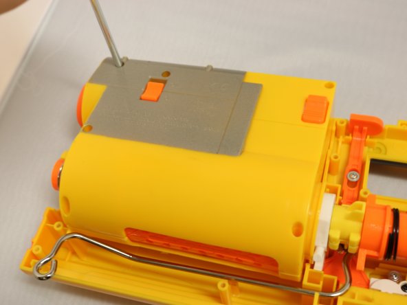

    • Proceed to take out the hidden screws when the device is collapsed.
    • Hidden screws measure out to 1.7 cm
  2. Nerf N-Strike Deploy CS-6 Light-bulb Lens Replacement: crwdns2935265:02crwdnd2935265:01crwdnd2935265:02crwdne2935265:0 Nerf N-Strike Deploy CS-6 Light-bulb Lens Replacement: crwdns2935265:02crwdnd2935265:02crwdnd2935265:02crwdne2935265:0
    • Once the hidden screws are out, extend your device in stealth mode.
    • Once the device is extended out, proceed to take out the necessary screws as shown.
    • For the pump, the screw's length extends out to 1.9 cm. The majority size of the screws extend out to 1.3 cm.
  3. Nerf N-Strike Deploy CS-6 Light-bulb Lens Replacement: crwdns2935265:03crwdnd2935265:01crwdnd2935265:01crwdne2935265:0
    • Once all the necessary screws are taken off, the interior of your device should be visible.
    • Unscrew the orange barrel located in front of your device.
  4. Nerf N-Strike Deploy CS-6 Light-bulb Lens Replacement: crwdns2935265:04crwdnd2935265:01crwdnd2935265:01crwdne2935265:0
    • Now that the cover is off and the screws are out, pry off the barrel of the device.
  5. Nerf N-Strike Deploy CS-6 Light-bulb Lens Replacement: crwdns2935265:05crwdnd2935265:01crwdnd2935265:01crwdne2935265:0
    • Once the orange barrel of the device has been pried off, proceed to take the metal clip off from where it is currently located.
  6. Nerf N-Strike Deploy CS-6 Light-bulb Lens Replacement: crwdns2935265:06crwdnd2935265:01crwdnd2935265:02crwdne2935265:0 Nerf N-Strike Deploy CS-6 Light-bulb Lens Replacement: crwdns2935265:06crwdnd2935265:02crwdnd2935265:02crwdne2935265:0
    • As shown, use your Phillips #0 head screwdriver to unscrew the highlighted areas
  7. Nerf N-Strike Deploy CS-6 Light-bulb Lens Replacement: crwdns2935265:07crwdnd2935265:01crwdnd2935265:01crwdne2935265:0
    • Once all the screws have been removed, the cover for the light-bulb is able to come off.
    • Gently remove the cover to maintain the safety of your device.
  8. Nerf N-Strike Deploy CS-6 Light-bulb Lens Replacement: crwdns2935265:08crwdnd2935265:01crwdnd2935265:01crwdne2935265:0
    • When taking off the cover piece, gently place it above the device as shown.
    • Regarding the ligh-bulb cords, it should have a strip of tape to keep it down.
  9. Nerf N-Strike Deploy CS-6 Light-bulb Lens Replacement: crwdns2935265:09crwdnd2935265:01crwdnd2935265:01crwdne2935265:0
    • Near the light-bulb is the lens. Gently pry it off.
    • Correctly dispose your damaged lens.
  10. Nerf N-Strike Deploy CS-6 Light-bulb Lens Replacement: crwdns2935265:010crwdnd2935265:01crwdnd2935265:01crwdne2935265:0
    • Once you acquire your new lens, gently place it in front of the bulb.
    • As shown, the lens should be placed where the edges line up.
