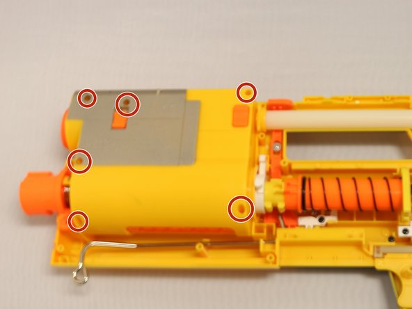

    • Before releasing the device in Stealth mode, take out hidden screws as shown
    • Extend the device in Stealth Mode by pressing the button found on the handle.
  2. Nerf N-Strike Deploy CS-6 Dart Tooth Replacement: crwdns2935265:02crwdnd2935265:01crwdnd2935265:03crwdne2935265:0 Nerf N-Strike Deploy CS-6 Dart Tooth Replacement: crwdns2935265:02crwdnd2935265:02crwdnd2935265:03crwdne2935265:0 Nerf N-Strike Deploy CS-6 Dart Tooth Replacement: crwdns2935265:02crwdnd2935265:03crwdnd2935265:03crwdne2935265:0
    • Take out the screws from the pump.
    • Proceed to take out the other screws from the device to take off the cover.
    • For the pump, the screw's length extends out to 1.9 cm. The majority size of the screws extend out to 1.3 cm.

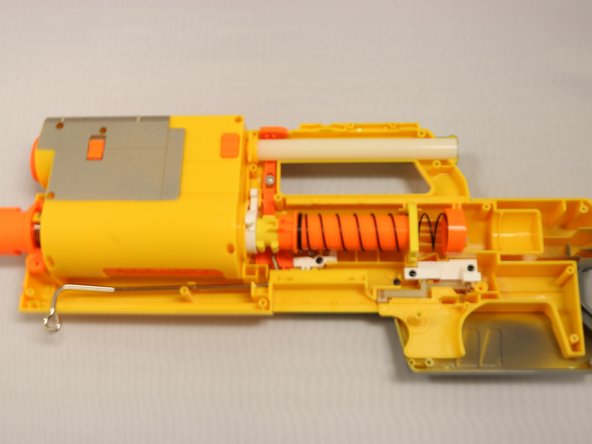

  3. Nerf N-Strike Deploy CS-6 Dart Tooth Replacement: crwdns2935265:03crwdnd2935265:01crwdnd2935265:02crwdne2935265:0 Nerf N-Strike Deploy CS-6 Dart Tooth Replacement: crwdns2935265:03crwdnd2935265:02crwdnd2935265:02crwdne2935265:0
    • Once the screws are out, you are able to take the cover piece off.
    • Proceed to remove the screws
    • Taking off those screws are vital in replacing the dart tooth.
