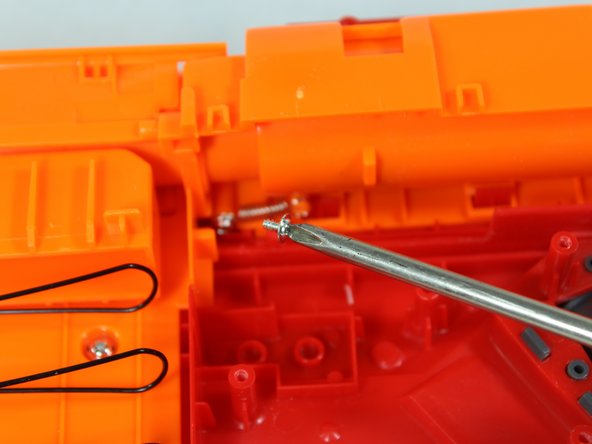

  6. Nerf Mega Magnus Spring Replacement: crwdns2935265:06crwdnd2935265:01crwdnd2935265:02crwdne2935265:0 Nerf Mega Magnus Spring Replacement: crwdns2935265:06crwdnd2935265:02crwdnd2935265:02crwdne2935265:0
    • Locate the small grey piece under the plunger tube and remove the screw.

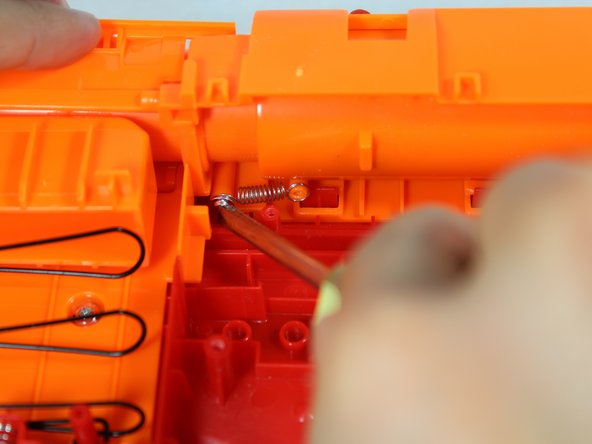

  7. Nerf Mega Magnus Spring Replacement: crwdns2935265:07crwdnd2935265:01crwdnd2935265:03crwdne2935265:0 Nerf Mega Magnus Spring Replacement: crwdns2935265:07crwdnd2935265:02crwdnd2935265:03crwdne2935265:0 Nerf Mega Magnus Spring Replacement: crwdns2935265:07crwdnd2935265:03crwdnd2935265:03crwdne2935265:0
    • Locate the screws on the return spring. Using a counterclockwise rotation, remove both of the screws.

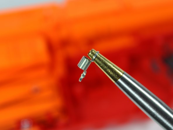

  8. Nerf Mega Magnus Spring Replacement: crwdns2935265:08crwdnd2935265:01crwdnd2935265:02crwdne2935265:0 Nerf Mega Magnus Spring Replacement: crwdns2935265:08crwdnd2935265:02crwdnd2935265:02crwdne2935265:0
    • Using a small tool, carefully remove the spring from its pegs.

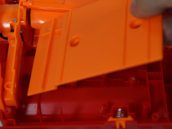

  11. Nerf Mega Magnus Spring Replacement: crwdns2935265:011crwdnd2935265:01crwdnd2935265:02crwdne2935265:0 Nerf Mega Magnus Spring Replacement: crwdns2935265:011crwdnd2935265:02crwdnd2935265:02crwdne2935265:0
    • Lift up on the magazine plate in order to remove it.
