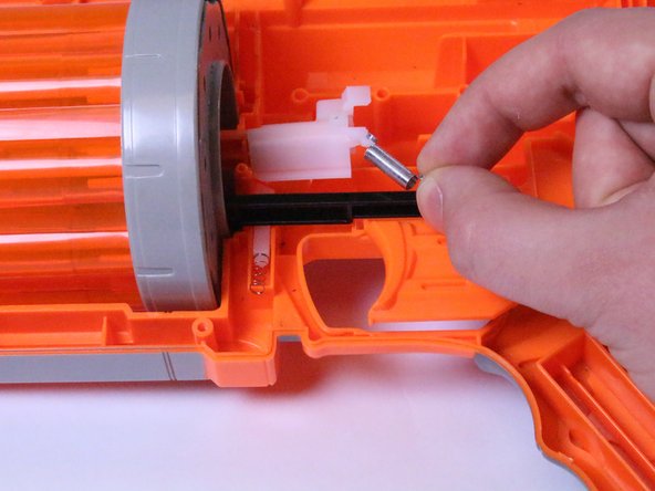

  10. Nerf Dart Tag Furyfire Trigger Replacement, Detach Black Piece from Trigger: crwdns2935265:010crwdnd2935265:01crwdnd2935265:01crwdne2935265:0
    • Using a plastic opening tool, detach the black piece from the trigger. You do not need to remove the black piece from the gun.
  11. Nerf Dart Tag Furyfire Trigger Replacement, Remove Trigger: crwdns2935265:011crwdnd2935265:01crwdnd2935265:01crwdne2935265:0
    • Once the black piece has been detached, the trigger can be lifted out of the device.
To reassemble your device, follow these instructions in reverse order. Ensure that the spring located behind the trigger is attached to the limb on the backside of the trigger.
